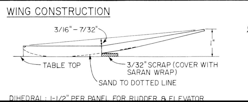

Post  andrew on Sat Jan 28, 2012 9:37 am
Here's an example of the wing construction. It uses a tapered sheet from SIG to build the Jedelsky airfoil, but you might be able to use a standard sheet of balse instead with the understanding that you'll be adding a bit of weight and the airfoil will not be as efficient.

Could someone explane how to build an wing with only a couple of sheets of balsa? And how do you get the V- shape in it?

Post  nitroairplane on Sun Jan 29, 2012 3:23 pm
Well you need to be good at sanding as you sand the aerofoil into it.
that "V" shape is called dihedral you make the wing in 2 parts and glue them together at the recommended angle to get the dihedral.

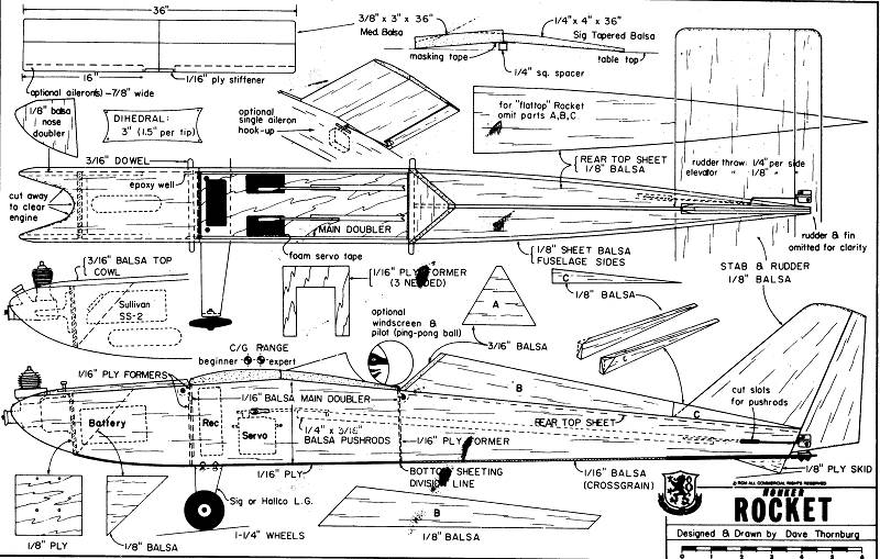

The Honker Rocket is essentially a Honker (same wing and stab), but with a rakish rudder and sleeker fuselage. They were used for a time in 1/2A class racing during the mid-eighties.
