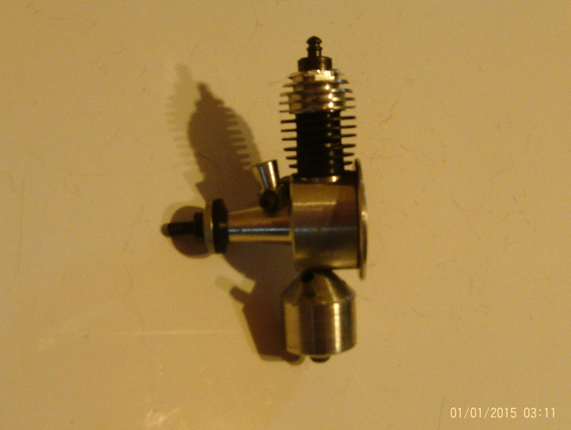

Hello all , I have acquired some of these engines and would like to get some more information so I can describe them correctly for selling and personal purposes because I will bee keeping some of them . I have looked but the info seems to be all over the place as far as engines and airplane designs , Some are Spitzy and also Jim Walker stamped on one as far as what size are the engines .020 ,.045, .049, .065 Here are a couple pics. I will get some more up later . Thank You guys for any help. I Know some are mixed with cox and OK ..... No.1 Looking for Info on Jim Walker Engines  Sell_910   No.2  Looking for Info on Jim Walker Engines  Sell_912  No.3  Looking for Info on Jim Walker Engines  Sell_911

Pretty sure the one on the left and the one in the second picture are K&B infants.

Post  Oldenginerod Fri Sep 02, 2016 6:08 pm
Eric.
First picture shows a K&B Infant .020, distinguished by 6 head fins. Beside that is an OK Cub .049B. The second picture is of a K&B Torp Jr. .035, with 5 fins. (Not called an Infant, only the .020 was). The third picture shows a K&B Torpedo .049 which used a standard glow plug rather than the inserts of the .020 & .035. For some reason they usually referred to the .035 as a Torp Jr rather than a Torpedo Junior. Just lazy I guess. It can be hard to pick the .020 from the .035, but the number of head fins gives it away. The .049 also has an extended prop driver.
I'm pretty sure that's got to be a Firecracker .065. I have the Royal Spitfire version which is beam mounted like your Jim Walker. I also have the .049 Spitfire which has a two bolt radial mount, so that's not it. The Spitzy is, well, a Spitzy. Remember, it's .045, not .049. They had different numbers on the front of the tank, which meant nothing really. The main difference was that the engine with the larger tank was referred to as the Spitzy Senior. Not sure if that's official.

Post  getback Sat Sep 03, 2016 7:23 am
Thanks to all that contributed I think Rod has pinned them all down and I remember the fin difference being brought up before but , could not find the thread ,was probably in some one that didn't have the destine route ? Found a thread from Ron in 2012 were he was showing off some of his Jim Walker / Spitzy engines and Superdave was wanting to purchase some from him Very Happy (hope he his OK ) I like the way Jim starts the boat in that vid. looks like a leather strap ! Now to figure out what to sell and what I can afford to Keep Laughing Rod is this Info found some where or you just Know it ?? I will try and remember the needle your looking for if I see one / and deflector throttle will bee hard to find the one I have don't seem to have everything there . bounce Eric Thumbs Up

Post  Oldenginerod Sat Sep 03, 2016 8:02 pm
No real source of information Eric.  Just somethings I've picked up over the years of researeching old engines I happened to buy.  The K&B Torpedo/Infant information is out there, just a lot of people don't realize what the differences between the three engines are.  As for the head fin numbers, I'm only going by the "Engine Archive" page on the MECOA website.  http://www.mecoa.com/museum/index.htm
I figured they should know.
