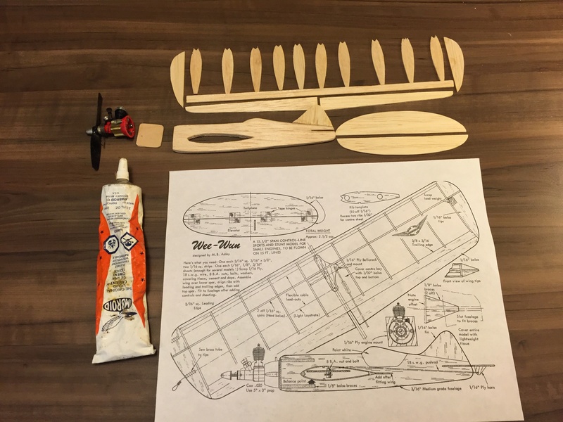

I had this build in mind from the beginning of the TE announcement. It's a "Wee Wun" from Aeromodeller 1968.
I cut the parts out by hand this evening, the ribs were a PITB. Some parts had to be cut twice as the cutting gets tricky in small scale.
I should have the wing built by tomorrow and will be a dope finish. Hopefully it turns out well enough to showcase the TE .010
Here is a picture of my progress so far...

Post  Kim Wed Sep 07, 2016 10:11 pm
Looks good! Is this another 'Born on the Road' project?

Post  Cribbs74 Wed Sep 07, 2016 10:23 pm
Why Yes!
On the road I have peace and quiet and time at my disposal. I can think of no better way to spend my time than knocking out a small build. I am sitting in Cape Canaveral so it seems fitting. Looking forward to a launch on Thurs...

Post  gcb Thu Sep 08, 2016 5:45 am
Cribbs,
It appears that you are using the tankless backplate, have you decided on a tank arrangement?
The Wee Wun and the Wee One are both on my bucket list...so far I have built neither.

Post  Cribbs74 Thu Sep 08, 2016 1:54 pm
gcb wrote:Cribbs,
George
Well, I want to use the tankless mount however, it's going to be tricky even with a small tank. I'll have to take some measurements, but I may be able to notch the wing as ling as it clears the bellcrank.

Post  Cribbs74 Thu Sep 08, 2016 1:56 pm
getback wrote:Cool Looking little plane Cribbs , where did you get the kit from ? Those small ribs are one reason I am getting Roger to cut me another micro ring for a build // My Zero is still hanging on the wall a waiting the TE (small) but am thinking spring of 2017 would bee OK with me winter SIS coming Cold
Not a kit, hand cut from plans. Pretty easy to do with these smaller planes. It's a good way to get rid of scrap balsa.

Post  Cribbs74 Thu Sep 08, 2016 1:58 pm
Keep in mind that I shrunk this one down to a 10.5" span. Originally designed around a TD .020, hopefully it will work out.
