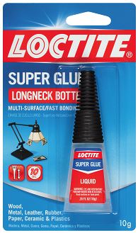

For general purpose use, my favorite glue and container is the long-neck Loctite 10 sec in the 10 gram bottle with a twist-off cap. It never clogs, and I can usually use a whole bottle over a few months, but once in a while I scrub the neck with a pair of pliers to clean it. Push and turn firmly and it's as effective as any cap I've ever used. It's also what I use to glue (human)skin rips too, Holding the injury high to reduce bleed out while it hardens. Sometimes finishing it with one ply of paper towel and re-gluing every day, protecting with a bandaid. Here's what it looks like:
I get it at Walmart in both the Hardware and Craft aisles. It's great for tacking things like ribs to LE/TE/Spars, because it doesn't spread, and then brushing on thinned wood glue to the rest of the joint. It's very good for holding down the curve of the center sheeting so you can then finish it with wood glue. I frequently apply baking soda to any small gaps prior to gluing fill in and add extra strength. This is really good stuff, and is my go-to CA for almost everything. The applicators fit tightly but you may have to spread them to get them to fit.
I just bought some of this 5 second CA and it looks promising, but I can't report on the container yet.
Lowes and Walmart both stock it. I don't buy CA online, so I can't answer that. I hope this is some help.

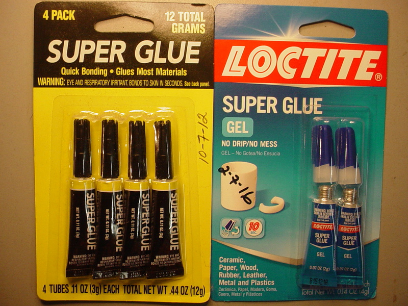

I'll add that I generally build small models.. and they've been far and few between as of late. The small 3g tubes serve me well.. and in the event that one dries-up.. it's not like I'm out a lot of money. It does go a long way as Ken mentioned.
I haven't bought any in almost four years.. but when I get down to one 4-pack of the "thin".. I usually buy another one. I've had good luck with the Henkel/Loctite brands. The "thin" 4-pack of 3g tubes is sold at my area Walmart stores in a generic-type/no-name packaging.. but is made by Henkel (Loctite). The package used to cost less than $1.00 but now it's $1.46.. The thick-gel type I buy at Walmart is Loctite-branded... and is a lot more expensive; at close to $3.00 for two 2g tubes.
Here's a photo of them side by side.
Again.. IMO.. it's all about the fitting of the joints when using CA.. (especially the thin-grade). You shouldn't expect it to fill gaps. I take the extra time that I'd spend waiting for other types of glues to dry.. to make good-fitting joints. If your making a balsa part.. make your cut(s) as square as possible. I use a razor-saw where I can.. with a rail of 1/2" sq. hardwood as a fence, to make my cuts as perpendicular as possible. A balsa-stripper with a good sharp blade and a straight-edge as a fence, works very good for making long-cuts in the direction of the grain. It's a very easy tool to make.. if you don't have one.
As far as assembling my pieces with CA joints.. I usually wear firm-fitting vinyl surgical-gloves and hold the two pieces together "firmly" for at least 10 seconds. I rarely use accelerator. I'm starting to wear the gloves more often now whenever handling any model parts. It keeps the oil in your skin (fingers..) off the surfaces. You can't really wipe-down balsa-wood construction effectively with an alcohol pad. Think about how much you handle a model during it's construction. There's oily fingerprints all over it by the time it's done.

Worst I've ever tried was "Gorilla". Useless stuff.
I like the looks of that, so next time I buy, I'll look for it.
