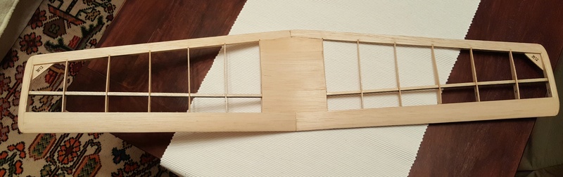

I started the build, with the wing. Before I get the TeeDee 09 by the mail hopefully next week and prepare the 3-in-1 firewall for all 3 engine options, I do not want to fiddle with the fuse.
Given the rough terrain over which I usually fly my planes, and the brute force of the TD 090 that will be the strongest option to drive the Cosmic Wind, I decided to reinforce the spar and leading edge both:
I embedded a 3mm dia carbon tube into the leading edge, and glued a 3x1mm carbon strip to the spar.
The plans show sheeting for the wing only on its top, the bottom remains covered only by monokote.
While the kit dates back to probably the early 60-s, the materials furnished in the box are big-time strong balsa and plywood..die-cut parts that easily and accurately detach from the parent sheets...
More to come later this week.

You're getting right down to business Andras!
I hope you're able to source a cylinder/sleeve for the .09. I'm assuming that your recent "wanted" thread is for this model's subject .09 engine.
Have you had any luck in securing a new place to fly? I was disappointed when you posted recent issues with the land-owner. Am I correct here? I could be losing my mind..
well.. some would agree that I lost my mind a while back..
I think that the carbon-fiber mods were good insurance. The .09 will likely turn-out to be "the engine" for this airplane IMHO. Actually...... I wouldn't count on a reed-valve .049 to fly this model. Building a 3-in-1 radial-mount firewall might cause vibration-issues to come to light when switching-over to test the rotary-valve engines. The "killer-bee" clone would certainly fly it.. but at the minimalist .049 Tee Dee engine recommendation. You could also experience "finicky" tuning/operation with the killer-bee. An easily-accessible bladder-compartment would need to be fabricated. I know that you've had great success with balloon-tanks in your models. Maybe it would make more sense to "save" the killer-bee for a purpose-built model.. and design aluminum-plates for an adjustable beam-mount system to accept the rotary-valve engine options?
