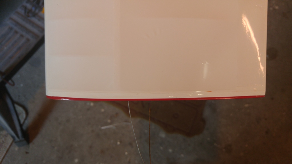

Okay, lets review. I wrecked the Tazz Twister in either the last week of October or first of November... we'll call it some time in Octember. Well I talked about what an adventure piecing it back together would be, bought a few sticks and sheets, and it finally got cold. So did my body and mind, because 2 weeks after the wreck, I had the neck thing happen, dousing my flames entirely, though I did unsuccessfully try to hide my distress. That's when an Umland wing kit shipped to my front door one lucky Thursday, compliments of the Great Fred Von Gortler... a big lift for me, thanks, Fred. I finally stopped talking about it around the first of February and started gluing the thing together.
12 weeks from then until today, with the finished wing now installed and covered, and damn near ready to fly, as slow as I usually am, that's not too bad if you forgive the short winter shop sessions. And now I've found I can fly patterns again, sort of. I haven't done one that would get the pattern points, and stumble around like a drunk, but I'm thinking I'll try an event in Huntersville this coming weekend. Hey, I gotta fly for Kim, he'll be there cheering me on. So maybe I'll actually complete my first pattern since October. Hell if I'm gonna fly my Twister on the tarmac, but My Tutor will stand in. I've almost completed one pattern with it and out of four flights, I've only crashed it twice, and once was when the plastic flap horn broke... I think. It did break, and I was flying very well at the time... That's what I'm calling it. We'll just forget about the Cardinal, which I also blame flap failure, but who's to know for sure. I've never been one to deny pilot error.
But anyway, Wayne says he'll flight trim the Twister for me. We hope to get to the Fort this week, but it's likely going to be windy, and I don't know if I can have Tazz ready for Tuesday. Thursday probably, but that's Stuntersville staging day so I can be packed and ready to roll out after dialysis first thing Friday with Holley at the wheel.
That pretty much summarizes my fall, winter, and spring so far. And to cap off the summary, here's what we have going on as of tonight:
Pretty slick, eh!
But... I still have to do fillets and attach the flaps and controls. Then re-install the powerplant. I have extra vinyl Tazz decals, so that'll be quick, and the paint touchups can wait until later. Sunday's goal is to install fillets, flaps, horns, rods, and leadout eyelets.
I'm only showing the wingtip because I like my little color transition at the edge. My camera died as I was shooting the same thing on the blue side. I accidentally reversed the colors. I had red on the OB tip before.
Pretty slick, eh!
- Posts : 10869
Re: Twister Wing - Maiden Flight Report from the Zaerodrome
Rusty, have you flown over asphalt before? While it's not a big deal, having a pull out reference certainly assists. In Huntersville, there's not a lot of them in the background. You might be able to use the tree line in your peripheral vision. Many tend to keep the maneuvers high which even in intermediate isn't a huge problem especially if you keep them all high. Unfortunately, some pattern points will be taken away but your scoring should be consistent from flight to flight. The outside square is one that many panic due to aiming the plane down towards the ground and the vertical eight tends to have a very oblong bottom. Ken
- Posts : 5253
Red is left, green is right. Same as on boats. The catch phrase to pass the test is "Is there any PORT LEFT?" Port is a red wine, and the left side of a boat or ship.
Now what colors you choose is up to you. That is fine looking and I love the even reveal on the top of the wing. I am sure I could pull that off, but probably not on the first try. I have never built anything with square tips like that. Since a twister or twister kit bash are on the list I might have to save this as a high bar to strive for.
