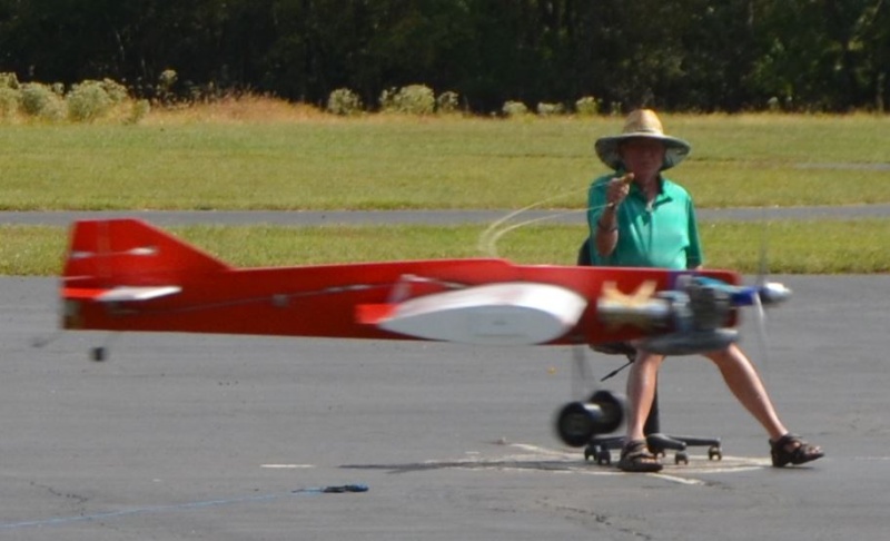

I am a bit torn on that LE, seems it would cut air very well, in stunt though we like to slow things down so we use a blunt edge. It hits the air like a battering ram and keeps things manageable.
That Twister probably needs that as it's being flown by an older person in a chair with a rich
run. Hence the slack lines...
Posts : 11888
Re: Twister Wing - Maiden Flight Report from the Zaerodrome
The sharp LE makes it hunt more than a blunt. That's the #1 reason for blunt Stunter LEs. They naturally stay in the groove during your judged flat laps, such as laps #3 and 4 of your inverted fliight, and lap #1 of your Takeoff & Level flight. And yes, stunt ships are designed to be draggy, just like their engines are designed to be slow and precise.
