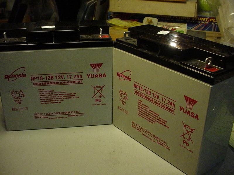

I asked if I could have two of several 12V lead-acid accumulators that had been received AVR (decommissioned) computer server-components that we deal with where I work. Boss said "no problem".
battery for field-box Yuasa_10
battery for field-box Yuasa_11
They're big batteries.. Laughing Yuasa has been the standard motorcycle starter-battery ever since I can remember. I need to load-test them to get an idea of their condition. What I assume are the date-codes.. are those 01-05 stickers on top.
I like the idea of being mobile while modeling. What I mean by this is; being able to go anywhere.. while having remote power-options to sustain your activities. An inverter would run an iron.... a Dremel.. a stereo!

11 year old batteries... good luck.

these type of sealed batteries last a long time, same type used in emergency lights, I've use 7ah batteries for flight box and last one was way over 10 when i replaced it, i do however doubt that they'll still hold 17ah, but to run a starter, glow driver (whats that?) you should be good, iron...not so much.

They have not bounced around in a vehicle for years so that's good and they are also clean with no cross leaks going on over the years from an oily/dirty film, another plus. Give 'em a try!

but that doesn't mean you can't get into them. Those covers can be popped off pretty easily. You can then check the electrolyte levels and add distilled water as needed. I have rejuvenated UPS batteries this way and they are/were sealed as well.

Thank You for the comments guys. These batteries weigh a whopping 13lbs. each.. but if I build a field-box for one, it will wheel like a dolly and have a detachable-handle for ease of transporting in the car. If these batteries won't hold a charge.. I'll just bring them back to work for their original recycling destiny. They didn't cost me anything. I've had two Hobbico TorqueMaster 12V 7Ah lead-calcium field-box batteries.. and neither one lasted very long.
