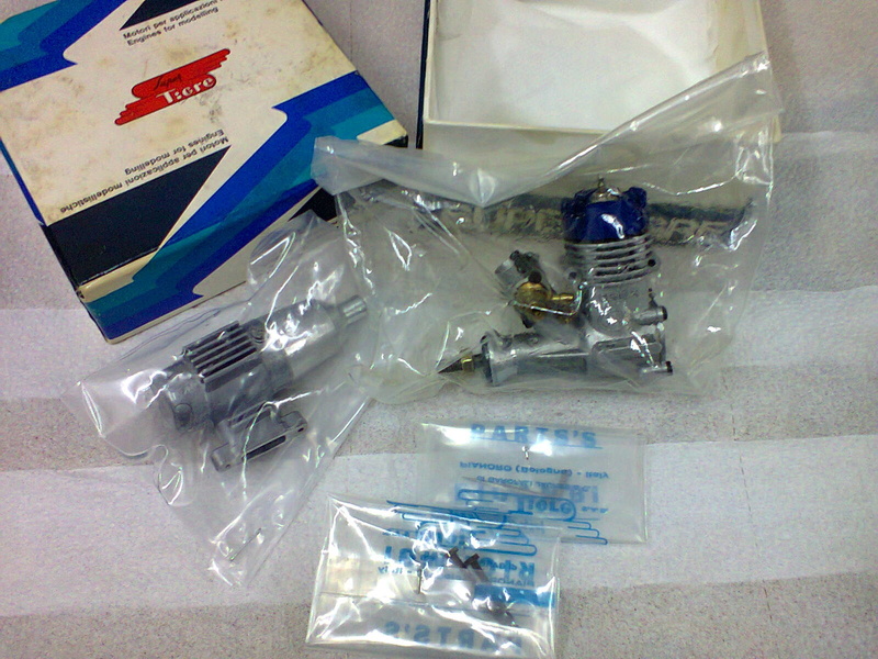

Hi, I am using you to know if you can give me information about this engine.
It is a ST. 11 made in Italy, I do not have a manual, if someone has the manual and can share it I will be very grateful.
I need to know which fuel is ideal, which I use or recommend.
Which propeller is ideal?
The engine was never started. Thank you very much for the information you can give me.

I have a few of them. Unfortunately the blue head one is their first version and it doesn't run very well in my experience. The compression ratio seemed very low and it would only run on large props. The later engines are better and better, peaking with their final ballbearing version.
You may notice that the engine "review" (linked above) hasn't actually run the engine (!), or at least they don't tell you about it...
My guess is that they where not impressed and didn't post the numbers in order to stay friend with ST.
If you do run it use plenty of castor in the fuel, 20-25% all castor, and use the carb restrictor if you have it. Otherwise you can make your own split tube to insert inside the barrel. The opening in the stock barrel is far too large to allow proper running, and all the the later models came with such a restrictor.

In order to provide some numbers, rather than just an impression of the performance here are some numbers on the Blue head engine and the later plain head engine (still plain bearing):
Blue head; APC 7x4 prop 14000rpm
Plain head; APC 7x4 prop 16800rpm
This was with 20% castor and 10% nitro fuel. As a comparison, an OS .10 FP will make about 15800rpm on the same prop and fuel.
