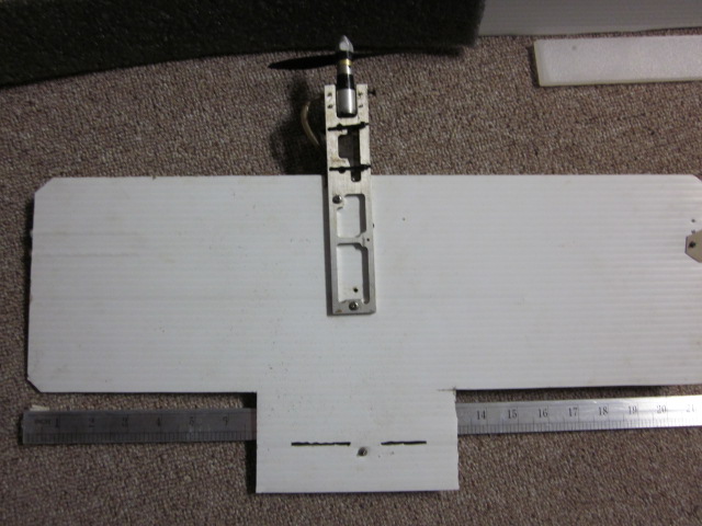

I will not take a lot of time, but just wanted to share a couple of pictures of recent builds I just completed. First is a Platter 15, but will be powered by an Enya 09 CL engine. Second is a ManWin Trainer that I built for someone. No build details as they were both quick and exactly as per the design/plans. Both are Coroplast and should fare very well for the inevitable, as my two ManWin planes have hit the dirt many times with NO damage except the 'firewall' slightly bending, and the odd propeller. A quick bend back and away we go. Anyways, enjoy.

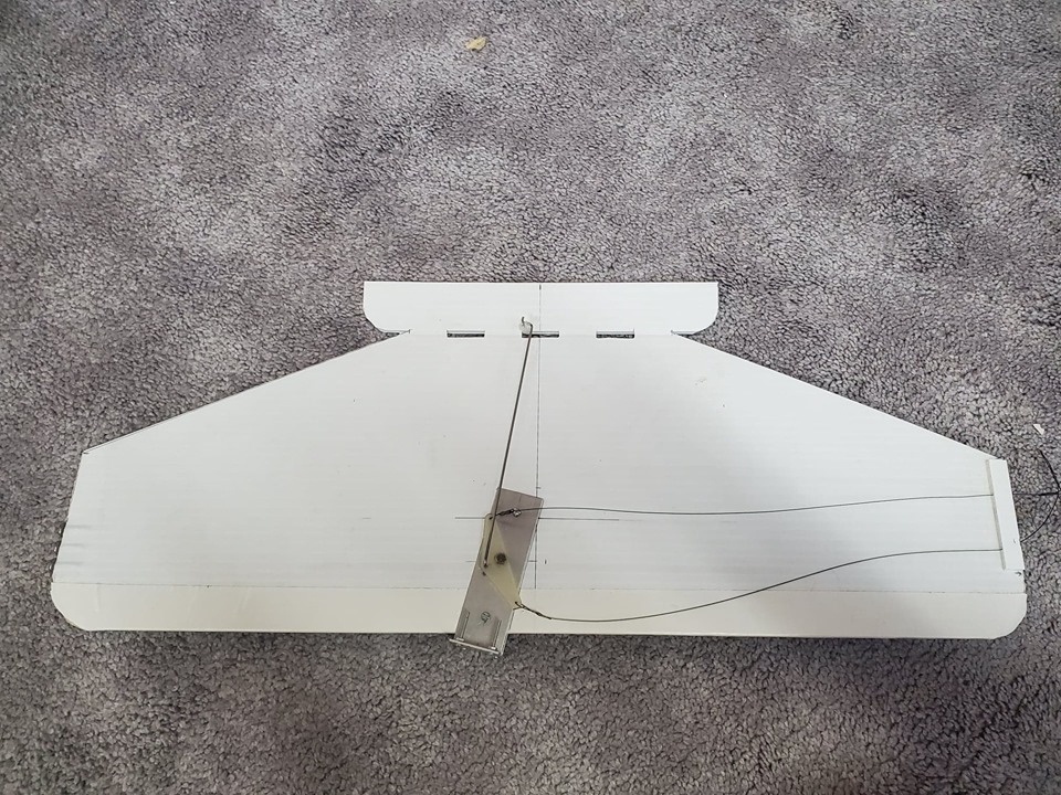

This is just a top view picture of one of my back-up planes.
This shows 3 screws screwed into the wingtip for counterweight, and are necessary. Do not forget to add these. Can also see the duct tape I used to 'wrap' the leading edge.

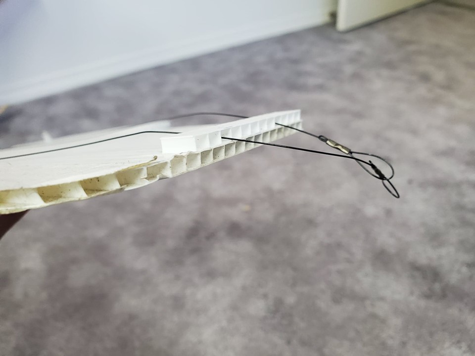

This is the leadout guide on the top of the wing. Lighter ran over both parts to be glued. Followed by a quick wipe with alcohol and allowed to dry prior to gluing together with dollar store 5 minute epoxy.
