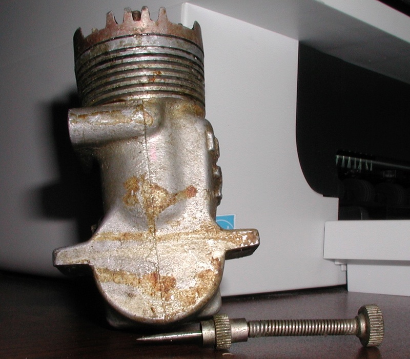

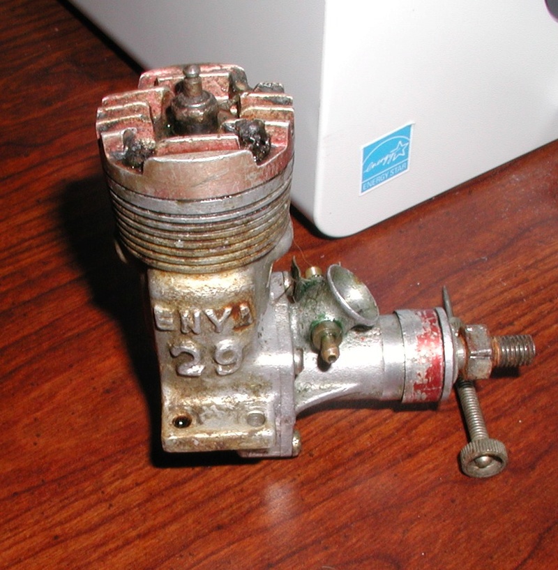

And so..........  Oh yes, an Enya .29.  Not just a .29 but one of the earliest sand casts.  This one has little collector value (see pictures) but it deserves a clean-up and some run time.  It won't get an A/F boil as that just wrecks the anodizing but rather some warm Simple Green externally and some heat to free it up.  Expect to see it chugging along in the next month or two.  After that I may disassemble and sand blast the sand cast then retire it to the Timex-go-around.
Next up - A sand cast Enya .29 Sandca10
These sand casts are notorious for not having perfectly level mounts.
Next up - A sand cast Enya .29 Sandca14
Next up - A sand cast Enya .29 Sandca12
Next up - A sand cast Enya .29 Sandca13
Next up - A sand cast Enya .29 Sandca11

Another treasure Bob. I am not an Enya collector - they just happen my way!
But - that would be one I would accept - The exhaust stack can be repaired and the the adonising restored. I would make a steel plug for the exhaust and then use Technoweld. It doesn't stick to steel.
http://www.techno-weld.co.uk/home.html
The repair would be visible due to the differing metals but after a bit of blasting - not so much. I use Technoweld to repair fins, mountiing lugs, venturis ..........
Takes a bit of practice and, in my case, a few blisters as I cannot resist touching metal to see of it is hot!

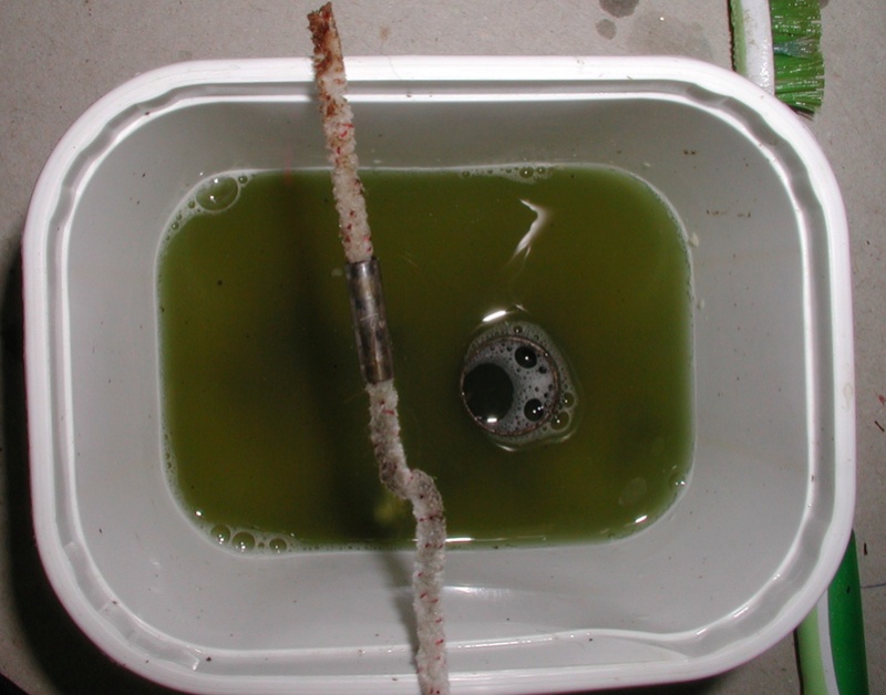

Post  rsv1cox Sat Jan 07, 2017 3:04 pm
For me early sand cast Enya's are full of surprises. They have very thin walled wrist pins with caps (think rim fire cases) on both ends sometimes steel, sometimes brass.  These two .29's also have different head gaskets, one a fiber composition, the other  a more traditional alloy.  Also they have flat head chambers with no relief for the baffle.  Baffling.  One has a venturi insert, the other doesn't, but the latter's may just have gone missing.
Next up - A sand cast Enya .29 _29_cl17
Next up - A sand cast Enya .29 _29_cl20
Next up - A sand cast Enya .29 2_29_s10
Next up - A sand cast Enya .29 _29_cl13
After a bit of a clean-up.
Next up - A sand cast Enya .29 _29_cl21
Alloy
Next up - A sand cast Enya .29 2_29_s11
I was going to try to run it before cleaning it up, but without heat it would just jam up again although a little fuel through the venturi might have loosened it up.  But it was nasty.  Cleaned up enough to run now.
Next up - A sand cast Enya .29 _29_cl22
Next up - A sand cast Enya .29 _29_cl16
I thought removing the prop drive washer would be a problem, Wasn't.
Next up - A sand cast Enya .29 _29_cl12
Next up - A sand cast Enya .29 _29_cl14
Next up - A sand cast Enya .29 _29_cl19
The good, the bad, and the ugly.
Next up - A sand cast Enya .29 2_29_s12
Posts : 9721
