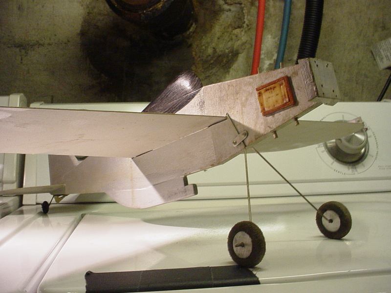

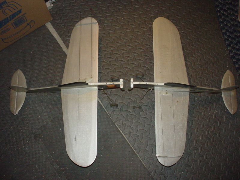

I built these two 1/2A C/L profile models sometime between 2001-2003. As you can see, I "eyeballed" the profile for the most part. I made a drawing as I usually do.. and have it with my other drawings/plans.
I'm not particularly proud of them..
but they got me back to building after about a seven-year hiatus after my divorce and finally had my "own" apartment where glue and paint fumes wouldn't bother anyone but me.
24" span/5.5" avg. chord/130 sq. in. wing; the two were built together and are nearly identical. Built to be powered primarily by Cox .049 reed-valve Product-Engine clones (horseshoe backplates) with 8cc external wedge-tanks. They have a brushed Aero-Gloss "Silvaire-Aluminum" finish.
The wheels I made from 3/4" hardwood dowel cut-offs with foam pipe-insulation tires.
The only parts I didn't fabricate are the bellcranks/horns, LG/straps, wheel-retainers and tail-wheels. Neither has flown.

Re: Roddie's SWOS P-51's
I Like em. I think they look pretty good myself. How do they fly?

Thanks Joe, I tried flying one of them once, shortly after building.. but had engine-issues. I didn't have a local field back then.. (still don't..) so they've both been hangared ever since.
I also feel that I could have given the tail-span another inch at least. There is decent elev. area though.
Yeah, those are decent looking. I agree with you on the short stab and elevator span. Maybe follow the curve of the stab onto the elevator for a Flitestreak style look. Some gussets behind the firewall might be a good idea. So would some decorations. They should be competent flyers.roddie wrote:akjgardner wrote:I Like em. I think they look pretty good myself. How do they fly?
