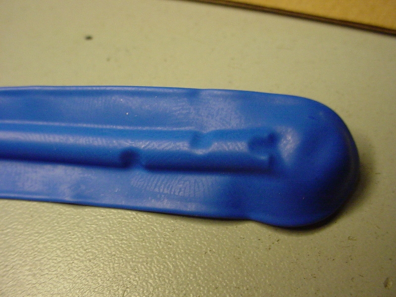

Balloon-tanks are something you might want to try.. Not a bladder.. but an airtight "collapsing" vessel that needs no vent.. and isn't particularly sensitive to location (elevation). The pick-up tube usually has multiple "notches" cut into it, to assure flow if a passage becomes blocked by the collapsing balloon.
