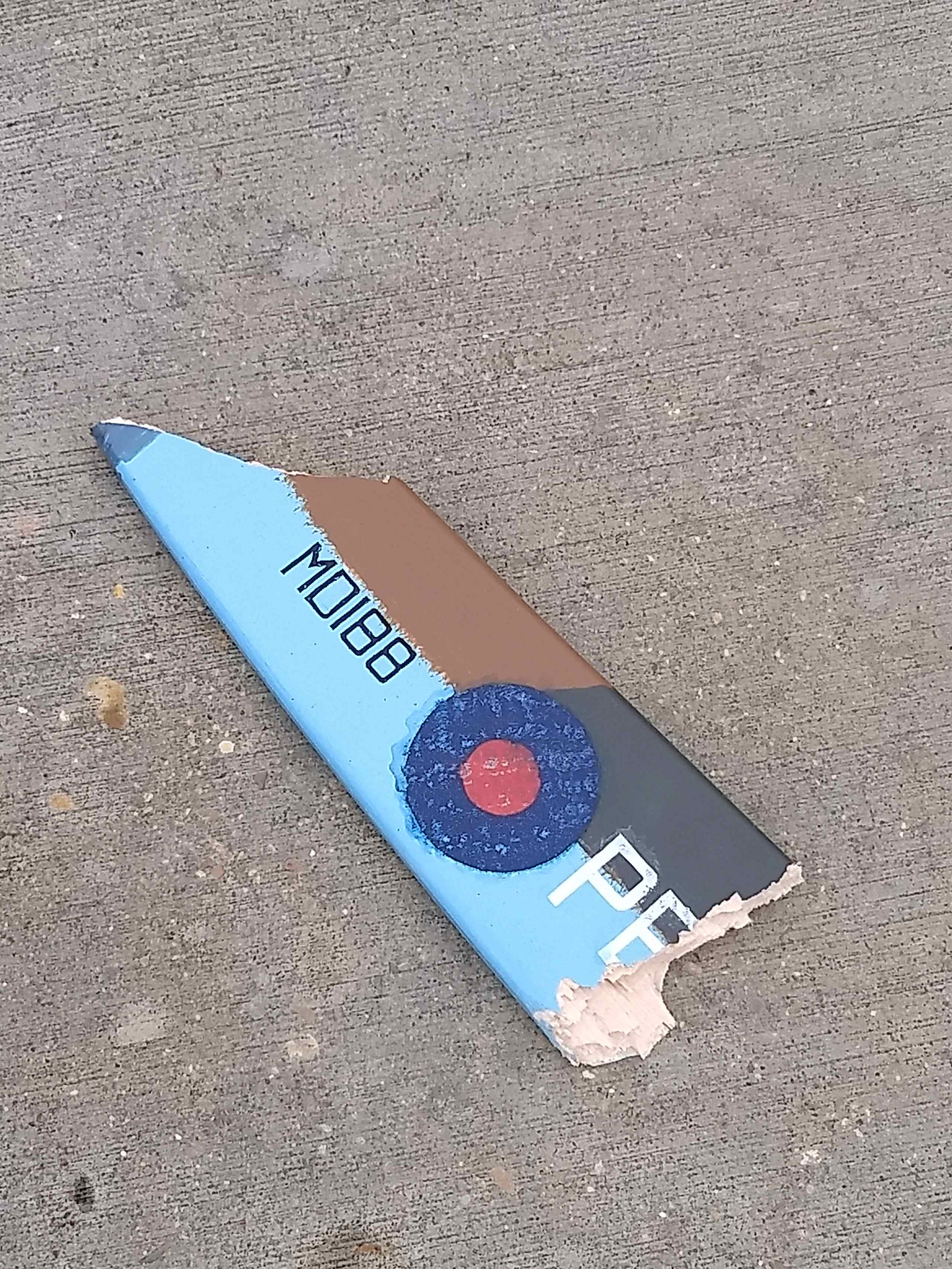

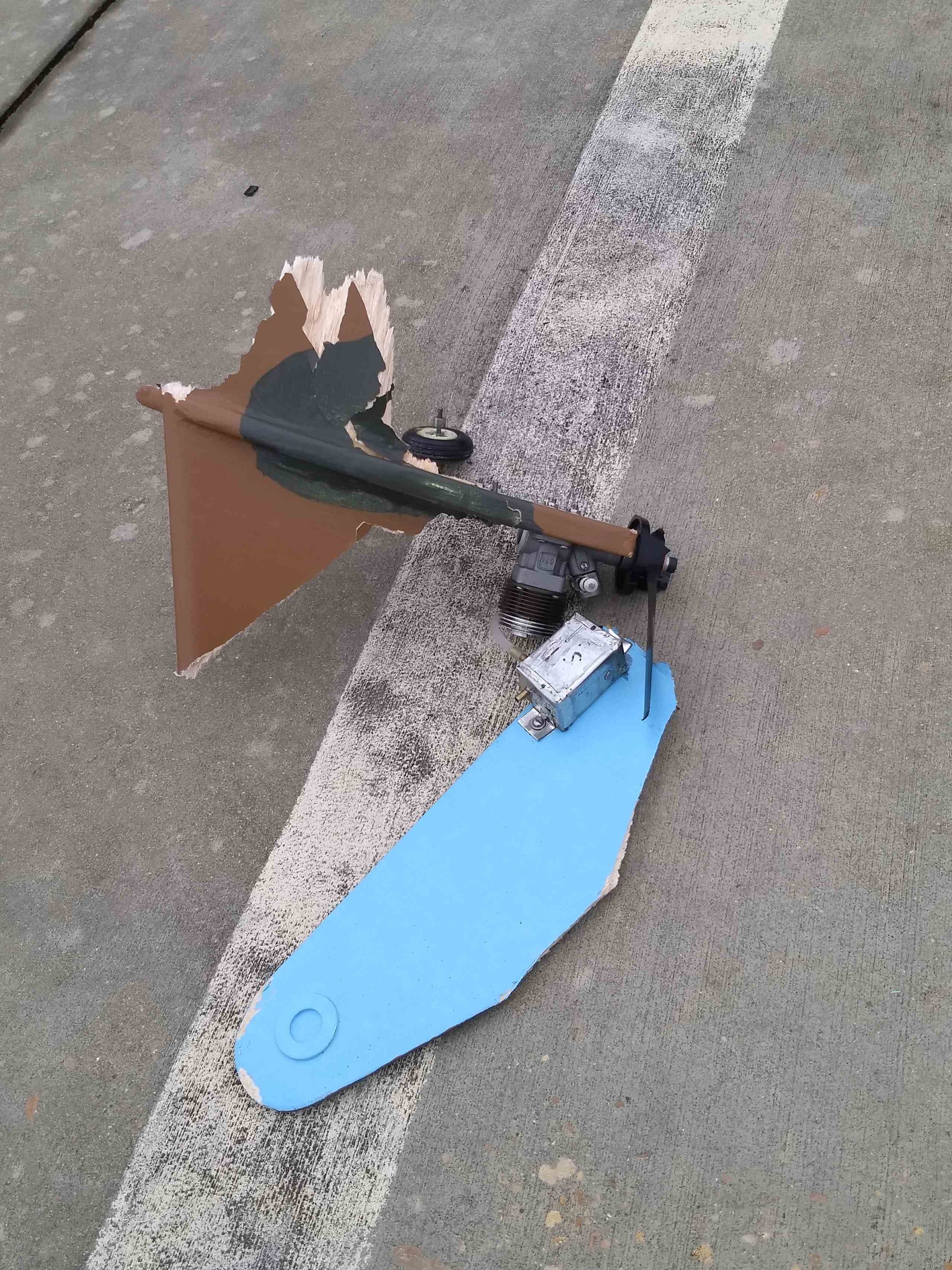

Well, the end if another airframe. I'm still trying to process the flight conditions prior to the crash. I seem to remember a smoke or spray coming from the inboard engine, then a momentary sag before flame out.
I was just climbing into a pretty steep wing-overs, and then the plane sliding in to the center of the circle. I could NOT backup fast enough.
A significant amount of fuel remained in the inboard tank, and the muffler pressure line was loose. I think the line blew off, the pressure-bled fuel dump was what I saw, just short enough in time that the engine just quit and the plane rolled in.
Pics of the carnage:

That's a darned shame, Jim. What a bummer. By the lack of dirt, looks like it hit pavement rather than grass. The good news seems to be that at least the engines aren't too badly damaged. Looks like the inboard didn't even scuff the spinner. Did you find both mufflers?
My dad always said that there are only two kinds of flying models, those that have crashed and those that are going to. Cost of doing business, I guess, but it doesn't make it any easier.
