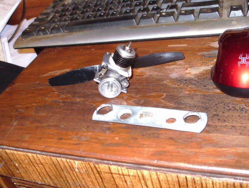

Jim won't run ??  Empty Jim Walker Wrench ??
Post  getback Wed Mar 01, 2017 5:01 pm
Ok it still wont run needs a deep cleaning when i went back to try again there was Green Ole Nitro coming out the drive plate area , my Question now is .. Is this the wrench for this engine ??  Jim won't run ??  Jim_w_14
Jim won't run ??  Jim_w_13  It wants to fit but there has been activatie in the rear that was slipping sooooo it don't want to just slide in there Mad and don't want to mess up the wrench for sure !! May take some filing ?  Any one know if it the right one ?? Thanks !!  This Site Rocks!

Post  rsv1cox Thu Mar 02, 2017 6:57 am
It looks like the larger hexagon should fit Eric, but if it's slipping with the possibility of causing more damage to a valuable engine I wouldn't push it. I have never seen a wrench like that so I don't know. I have removed those back plates before but don't know exactly how I did it, probably loose to begin with.
