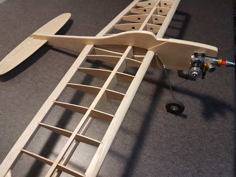

Post  Canso07 Thu Jul 06, 2017 9:30 pm
I finally got the main wing built up, its been hard trying to find time to go and build with family and other projects/models on the go. Just have to sheet in the center section of the wing and finish the tips. I'm going to also epoxy the engine bay and surrounding area with thinned out 30 min epoxy to protect it from fuel. It's starting to look like airplane, hopefully this weekend I can do a bit more.

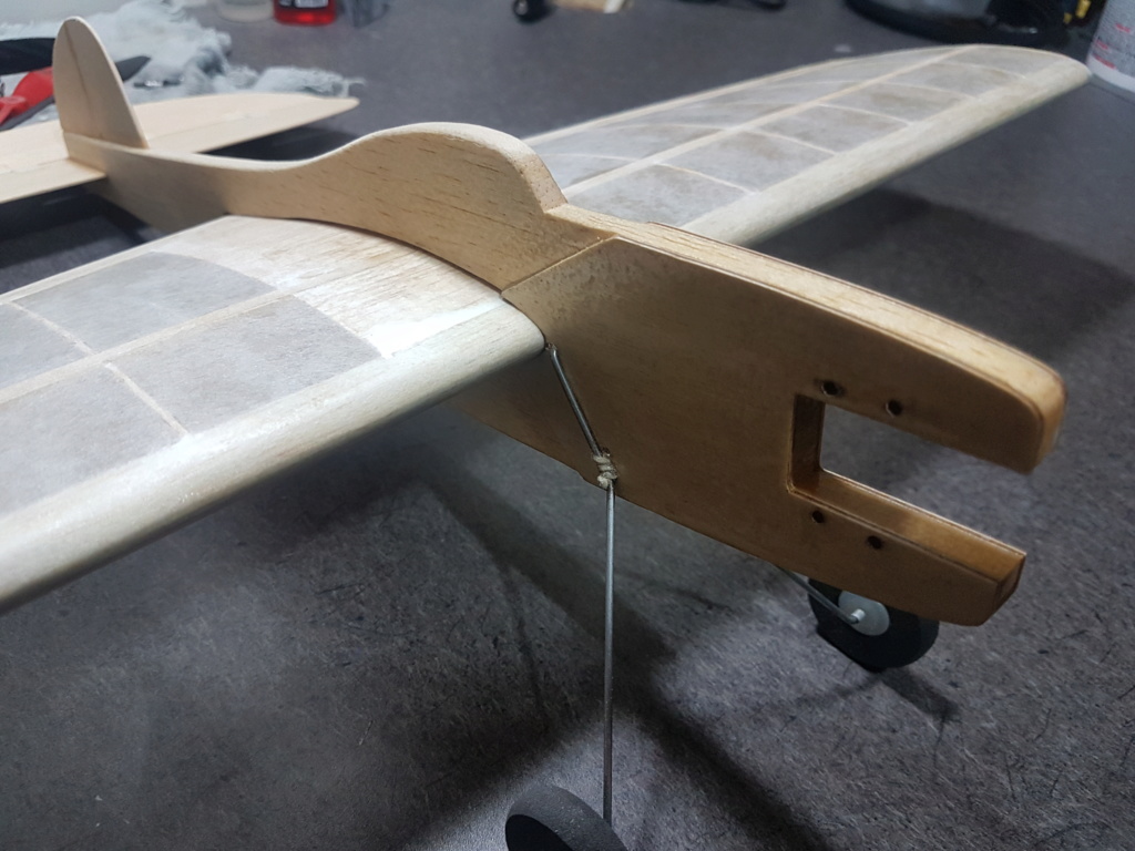

Post  Canso07 Wed Aug 08, 2018 11:27 pm
Finally got some more progress on the ringmaster. I got the nose epoxied for fuel proofing, first time I did that method with thinned out 30 min epoxy and I like it.
I got the wings covered which was a huge step! I went old school and used tissue and dope, turned out all right for not doing that method in awhile.
I want to fly it this summer so more work coming!

Baby Ringmaster build - Page 2 Empty Re: Baby Ringmaster build
Post  Canso07 Wed Aug 08, 2018 11:30 pm
Baby Ringmaster build - Page 2 20180813
Baby Ringmaster build - Page 2 20180814
Post  1/2A Nut Thu Aug 09, 2018 12:32 am
Great job on this one Canso07 mega points for you, nice and clean  Thumbs Up
I like the bare all aluminum crank case good cooling for sure!
Beer Cheers
Post  getback Thu Aug 09, 2018 8:13 am
MAn that looks GREAT !! You have done a good job on the wing / tissue what did you use to thin the epoxy with for fuel proofing ? Looking forward to the finished product !
Post  GallopingGhostler Thu Aug 09, 2018 12:45 pm
Really nice work, Canso07; can see the Ringmaster Jr. heritage. Thumbs Up
Post  Canso07 Thu Aug 09, 2018 1:11 pm
Thanks for the comments. I used methyl ethyl ketone to thinn the epoxy, outside of course its very powerful.
