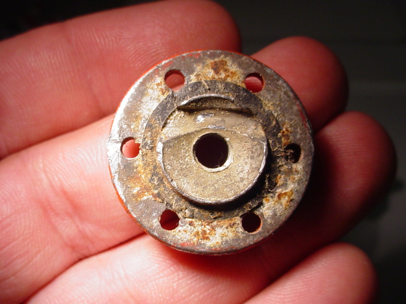

@706jim wrote:I owned a McCoy 19 way back when. This was before electric starters. I never could get it to run. It the sleeve was installed backwards, would this cause hard starting?
I have a McCoy .19 that was my dad's. I received it recently from him with its head off.. and missing most of the screws to reinstall it.
A bumbling day with the McCoy 19  9-28-110
A bumbling day with the McCoy 19  9-28-111
A bumbling day with the McCoy 19  9-28-112
A bumbling day with the McCoy 19  9-28-113
I'm not sure how/if it ran when he had it. What I "do know" is that it was once mounted in a beautiful Sterling Waco Cabin C/L model that he'd built when I was a toddler. Back then; Sterling furnished beautiful spun-aluminum engine-cowlings with their kits.
It's really amazing that I have the engine in complete form. That Waco never flew to my knowledge.. and my dad lost interest in the hobby by the late 60's. The Waco got "played-with" tossed-around and broken soon after. We moved to another house in 1976.. and I really don't remember the model or its engine from that time.. on.
A bumbling day with the McCoy 19  195610
I remember my dad's vividly. It was beige with red trim. The engine cowling was gorgeous.. with the red-head proudly protruding out the top.. (sounds naughty.. doesn't it?) Laughing
I've been half-heartedly searching for some 3-48 black-oxide cap-screws to replace the missing ones for the head. If I was really serious about restoring the engine.. I'd contact "Chellie" (Michelle?) A girl that procures some vintage McCoy gaskets. She could surely give some guidance on the running/restoration of the red-head glow-engines. She used to have an eBay store. Not sure if it's still active though.
The .19 engines I would agree; are stuck between "a rock and a hard-place".. as far as kits for them are concerned. Mostly regarded as a "stepping-stone" engine for applicable kits, that many modelers may have skipped-over.. to proceed to the top of the displacement recommended.
The Fox .15 steel-fin enjoyed more popularity I think. An old .09-.15 kit/design was ripe for one.

@Ken Cook wrote:          Jim, if your referring to the red head .19 it certainly could've been 180 deg out. This isn't possible with the .35 due to 3 screws holding the cylinder to the case. The .19 though can be rotated. Hard starting would've certainly been an issue if this was the situation. I have witnessed this with Fox .35's that have been taken apart and not properly put back together. The Mccoy .19 though has it's porting very close to each other and almost identical in width. This makes identifying the intake side to the exhaust side very difficult. In addition, the Mccoy has it's steel liner blued entirely, on a Fox it's raw steel and the steel naturally discolors from the heat of the exhaust so it makes identifying one side to the other much easier.
              The Mccoy has paper fiber gaskets which sometimes don't seal properly. This is very easily overlooked at the base of the cylinder. If it's leaking it's not going to offer good compression and poor compression is mistaken a lot of times due to this gasket. In addition, the head gaskets were fiber which leaked as well. This is another problem easily overlooked even by the experienced. These two areas cause hard starting and reliability. In addition, the spraybar never sealed correctly to the case. This can cause erratic needle setting and poor fuel draw requiring the needle to be way out to get it to just draw fuel. While I'm a fan of the Mccoy needles and spraybar, they leak therefore requiring tubing on the threads.
                I do like the Mccoy .19 and it does a good job but it is in my opinion one very loud engine even louder than the .35. Ken
"Pearls" Ken.. text saved to my McCoy .19 archives.. as many of your helpful hints have been. Thank You! I hope that Eric reads this before abandoning trying to run his engine.
The back-plate in my dad's .19 looked to have been installed/re-installed 90 degrees too far clockwise. See the pics I took soon after receiving dad's engine.
https://i.servimg.com/u/f58/18/50/45/90/9-28-114.jpg
There's no-telling (yet..) whether he had the cylinder-liner out of it. I'm guessing.. no, but won't leave that stone un-turned.
I had that kit in the 1970's, it disappeared when I went away to the Army. I bought a Testors McCoy .19 RH from America's Hobby Center, I think I paid all of $6 plus postage. The .19 was considerable longer than the engine shown in the Sterling Waco Cabin, comparing with the plans, prop hub stuck out 0.5 - 0.75 inches past the cowl, so I put it in a Sterling profile F-51 Mustang.
