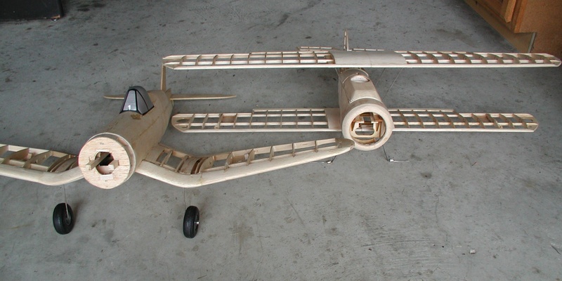

Lot's of rough edges, but on this re-build I'm putting up with them. Full scale F4U wasn't exactly smooth either.

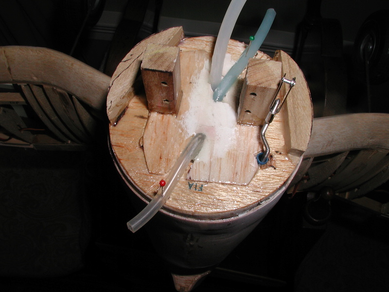

Needing a level surface to paint the firewall with epoxy, I used the furniture.
Lot's of plumbing there dictated by the vertical central mounted fuel tank that needed sealing. I filled it with balsa scraps and skimmed with filler and painted with epoxy. The whole thing will be over-sprayed with Insignia blue.

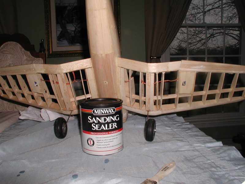

The local Hobby Town closed, my source for Aero gloss sanding sealer, and ebay stuff is $7.00 + $7.00 shipping for a 3.5 oz. bottle so I bought a qt. at Lowes for the same price. Water based it goes on nice and dries to a sandpaper finish in one hour. I will knock that down and apply a second coat then primer and cover coat. I painted a sacrificial piece of balsa to ensure compatibility with Lustrekote before painting the Corsair.

I had the whole thing assembled only to tear it all down again.

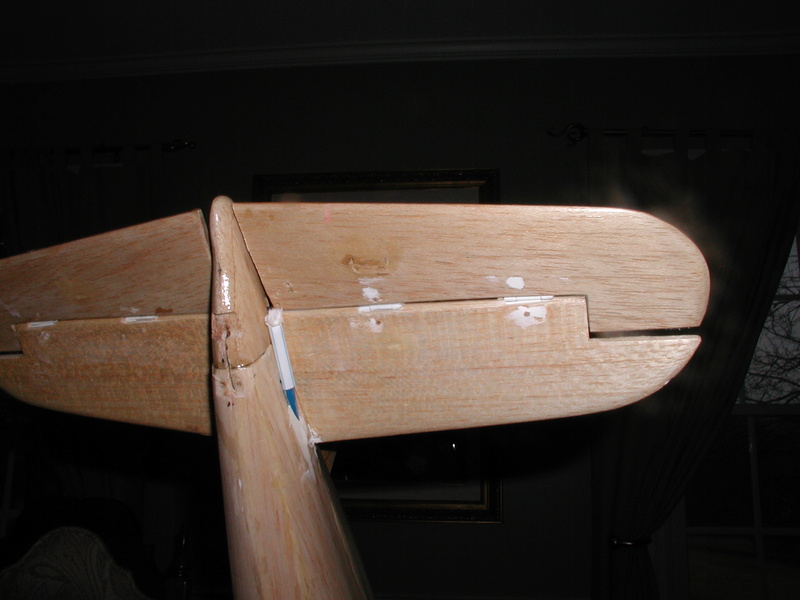

PS - My son flew this Me-109 model this past weekend and smacked it in. No landing gear and the right wing caught and snapped on a diagonal mid-way, an easy almost invisible repair. Will fly again.

Bob, thanks for doing the sanding sealer test. So, sanding sealer is sanding sealer, soaks in and seals,as long as the finish coat is compatible. Good to know. I hope to get that far in a build someday!

So far, so good Rene. I don't know about being fuel proof or not, but it will be surfaced with Lustrekote.
First S/S coat soaked in well. I knocked it down with 400 grit after an hour, hit it with compressed air and added the second coat which dried nice and smooth, but I sanded it anyway. Primer and color goes on tomorrow, then Monokote on the wing.

What does the sanding sealer smell like? Any chance you can test compatibility between the Mineax SS and some old school dope?
I'd love to think we may have a cheaper alternative to dope SS.

This time of year I'm pretty stuffed up, but nothing out of the ordinary that I could detect. Can says, "use with adequate ventilation" but I considered my dining room was ventilated enough, and it's warm.
