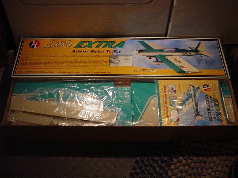

Congrats on the Norvel engine purchases guys! I'm not an "Ebayer".. but I'm thinking I should be now. The TV version of that engine would be perfect for a Herr ARF kit that I bought many years ago. It's still NIB..
I believe that the Norvel .074 is the recommended engine. I'd need several hours on an RC trainer.. before I could even think about flying the Lil' Extra. It was one of those "some day" purchases.. same as my Ace "All-Star" bipe. I did buy an OS .10 FP RC for the Ace kit though. All are still NIB stuff.. for someday..
If I "buy the farm" before someday.. one of you guys will surely end up with my stuff. My wife has instructions.
