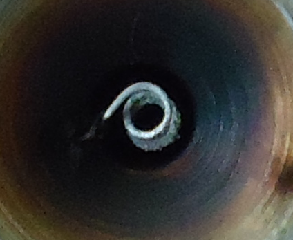

Post  MauricioB on Wed Mar 29, 2017 10:15 pm
These photos that I leave here, corresponds to my Tee Dee 051, many months that I use and it works, but when looking at it with a magnifying glass, the resistance is seen as peeling, this is part of the metal ?, what happens there? It is normal? Is it due to a glow plug already used ?, time to change it or can be washed?

Post  Cribbs74 on Wed Mar 29, 2017 10:25 pm
A Cox glow plug can last a really long time, if your fuel is of good quality and your compression optimum.
I think what you are seeing is a buildup of ash. This is usually seen when using old or contaminated fuel. It can be cleaned.
If you start to have hard starts and RPM loss when the battery is removed then it's very likely the platinum coating is degrading.

Post  MauricioB on Wed Mar 29, 2017 10:30 pm
Cribbs74 wrote:A Cox glow plug can last a really long time, if your fuel is of good quality and your compression optimum.
It is likely that the fuel components will not be of the best quality as they purchase the products separately, ie oil, nitromethane and methanol. Here in my country is prohibited the sale of pure methanol, what is achieved is methanol but with some additive not to sell it pure.
Thanks for answering me !, tell me how I can clean the beard? With which liquid and / or method ?, thanks!

Post  MauricioB on Thu Mar 30, 2017 7:45 am
Well boys, here I show that I made the attempts to clean the filament of the candle.
Use an airbrush at 30 bars of pressure and 80 bars of pressure, with thinner, the result is that the ash-like residues disappeared, but what is observed in the photo is the degradation of the filament, that is, that the filament itself has Gone deteriorating, still works, but it does not pay any more. I am now taking accounts to see if I can deduce how much time I used and thus have a data to be able to compare perhaps with your experiences.
After firing with thinner and airbrush, thus turns on:
And here you can see that the filament is deteriorated, it is not ash or residue, simply the filament is rotten ... but still works, but not with good performance.
Time to change the Glow Plug!

That ash might be corroded platinum, meaning the battery will cause the coil to incandesce brightly but methanol may not. Thus, reduced performance. Too much silicon anti-foam agent can cause this sort of malady. I had a batch of Sig fuel back in 2012 or so that I blamed for ruining every plug I had, turning them snow white. Some sort of impurity that you may never pin down.

Post  MauricioB on Thu Mar 30, 2017 9:48 pm
RknRusty wrote:That ash might be corroded platinum, meaning the battery will cause the coil to incandesce brightly but methanol may not. Thus, reduced performance. Too much silicon anti-foam agent can cause this sort of malady. I had a batch of Sig fuel back in 2012 or so that I blamed for ruining every plug I had, turning them snow white. Some sort of impurity that you may never pin down.
Thanks Rusty for your information, believe me that I am learning a lot from the experience of all of you. In my club, I had never seen such small models fly, and I am the first in 30 years to fly a Cox .010 R / C, passing through 020 and up to Cox .15, many friends and colleagues are left with the Mouth open to see how they work, you almost can not believe !.

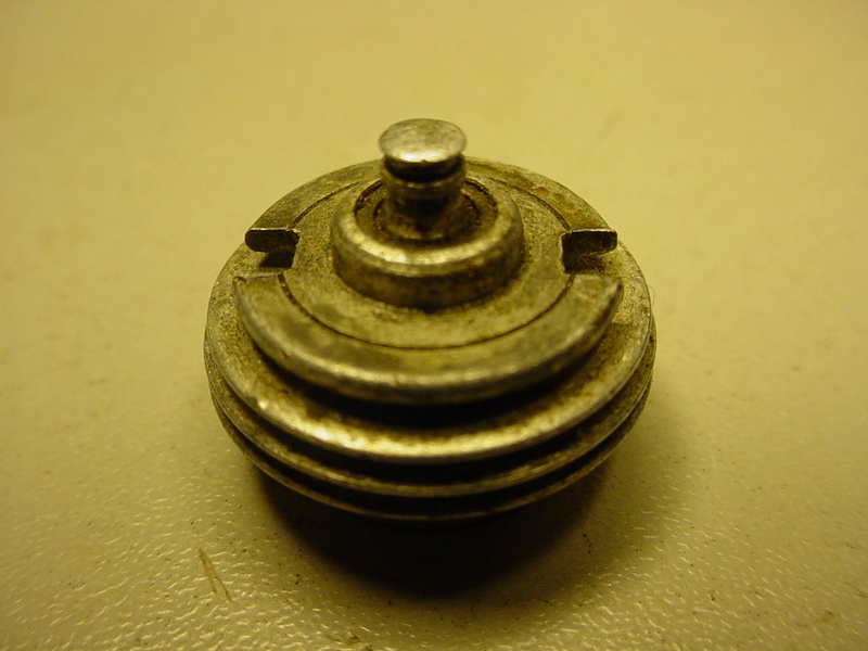

Post  roddie on Fri Mar 31, 2017 7:53 pm
Hi Mauricio! I have many Cox .049 glow-heads that are VERY old (30, 40 and possibly 50 years old..) They still work, but I'm unsure how many hours of use any of them have had. Many of them were in my family for years.
I haven't had many Cox glowheads fail. I have a few that have the old "W"-filament design.
Here's some photos of them..
I've never run them.. so I don't know how they perform. I believe that the conventional "coil-design" is more efficient.
Here's how I "keep" my standard .049 glowheads..
Smile .. I apologize that this doesn't give you answers for your question. I can tell you that I have always ran high-nitro fuel in my engines.. (25-35%) When genuine "Cox" fuel became unavailable, I switched to the "Sig" brand.
Do you filter your fuel? It would be smart to filter it.. because of what you mentioned about the way that it's formulated. It may be subject to some contamination if the person/people who mix it aren't careful and clean with the components. Be sure to keep/store your fuel away from sunlight.. and sealed tight.

All the info here is great advice. Glow Head/Plug life is dependent on three major factors, Weather/environment, How it is run/setup and Fuel quality and Roddie hit it on two major things Keeping fuel filtered and Keeping it out of direct sunlight, Sunlight kills nitro fast so it's best to keep it covered or in shade while out at the field or store it in a fuel can. The Environment (dusty conditions) can shorten life due to fine debris entering the engine which can wreck havoc on plugs, Weather effects Needle settings and a sudden weather change such as a coming storm or drop or increase in temp can cause an engine to go from perfectly set to a screaming lean run or sloppy rich in a blink of an eye which can blow plugs in itself. Running an engine rich while it doesn't hurt the engine, it can coat the plug with carbon especially if you run high castor. Fuel quality as stated has a big influence especially poor quality methanol Methanol is the catlist which reacts with the platinum element that keeps it glowing hot and poor methanol or methanol that has soaked up some water can reduce the reaction with the element as well degrade it. Engine setup is also important (ie) compression ratio, exhaust and matching the proper plug to the setup you are running is also a big factor. I've had plugs last me for years and I've killed my share of plugs too with a few that tried their very best to imitate a flash cube (power panel blunder) YUP I did it too! My best head nuke not only blinked brightly through the exhaust slit but almost sounded like a lady finger firecracker lol. Anyway hope this helps man take care (Bandit)

roddie wrote:Hi Mauricio! I have many Cox .049 glow-heads that are VERY old (30, 40 and possibly 50 years old..) They still work, but I'm unsure how many hours of use any of them have had. Many of them were in my family for years.
Roodie good to read you again! .... I have a Furi 049 engine that has that type of glow plug "W", I take care of it infinitely, I start this engine only from time to time since I do not have a spare glow plug! ! I would not want to waste it or damage it!

TDbandit wrote:All the info here is great advice. Glow Head/Plug life is dependent on three major factors, Weather/environment, How it is run/setup and Fuel quality and Roddie hit it on two major things Keeping fuel filtered and Keeping it out of direct sunlight, Sunlight kills nitro fast so it's best to keep it covered or in shade while out at the field or store it in a fuel can. The Environment (dusty conditions) can shorten life due to fine debris entering the engine which can wreck havoc on plugs, Weather effects Needle settings and a sudden weather change such as a coming storm or drop or increase in temp can cause an engine to go from perfectly set to a screaming lean run or sloppy rich in a blink of an eye which can blow plugs in itself. Running an engine rich while it doesn't hurt the engine, it can coat the plug with carbon especially if you run high castor. Fuel quality as stated has a big influence especially poor quality methanol Methanol is the catlist which reacts with the platinum element that keeps it glowing hot and poor methanol or methanol that has soaked up some water can reduce the reaction with the element as well degrade it. Engine setup is also important (ie) compression ratio, exhaust and matching the proper plug to the setup you are running is also a big factor. I've had plugs last me for years and I've killed my share of plugs too with a few that tried their very best to imitate a flash cube (power panel blunder) YUP I did it too! My best head nuke not only blinked brightly through the exhaust slit but almost sounded like a lady finger firecracker lol. Anyway hope this helps man take care (Bandit)
Hello Bandit
Taking into account all your comment, I deduce or summarize that the problem that I can have here, is the quality of methanol, since I can not check or check their quality or level of purity. I am referring to chemical purity, not by residues, since I filter this if I suspect its quality.

Post  GallopingGhostler on Sat Apr 01, 2017 5:42 am
MauricioB wrote:These photos that I leave here, corresponds to my Tee Dee 051, many months that I use and it works, but when looking at it with a magnifying glass, the resistance is seen as peeling, this is part of the metal ?, what happens there? It is normal? Is it due to a glow plug already used ?, time to change it or can be washed?
AFAIK, the nichrome wire glow element has a thin coating of expensive platinum metal, which is the catalyst for glow ignition. Once the platinum coating erodes or degrades sufficiently, catalytic action diminishes. The older Swanson Associates Fireball hot glow plugs I obtained in the late 1970's seemed to last a while. Then I obtained a dozen NOS on card about 5 years ago, that only lasted a season. Year later after winter non-fly, they would not fire. I read somewhere that Swanson ran into problems with a supplier and poor quality platinum coated nichrome wire.
An older Enya 30 plug that came with an old, dirty, rusty but not abused hardly used Enya .09-III TV (the 1967 left hand exhaust version acquired around 6 years ago) still fires.
that flaking off your worn glow plug element may be the platinum coating degrading, IMO.
