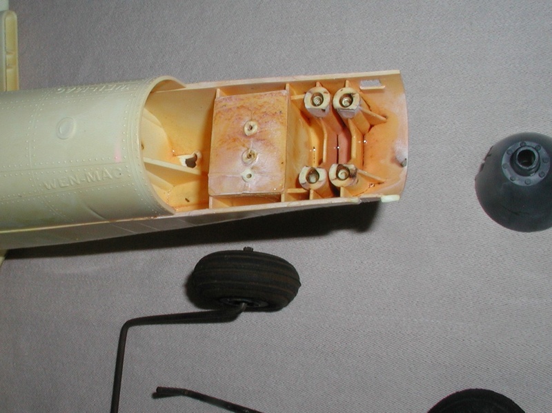

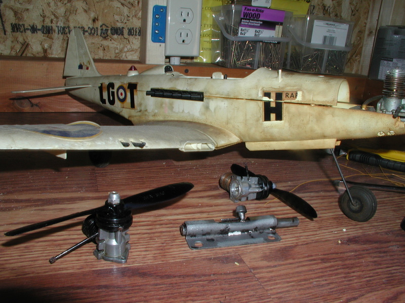

I guess that I'm going to have to build a stooge if I'm going to get any circle flying in this spring.
Looking around for a suitable victim to sacrifice in the name of regaining some resistance to the dizzies I recovered this plastic Airacobra/Kingcobra from the ceiling of the shed. I had hung it there last fall only dropping it in the process breaking the nose gear off and snapping the propeller in two. Still kicking myself for that one but no big deal, it's fixable.
I'm debating whether to rebuild the thing or just "fly" it as is. One half of the elevator is missing, but it's the "right" half. It still operates and the effect would be to roll the model up and to the outside of the circle. Ok I can deal with that. But the engine is seized and needs to be heated to free it up. Not a good idea when it's sitting in a plastic fuselage. But......... I think I can spray it with some Remoil and force it free. But....... the vent and filler nipples are both broken off on the fuel tank. But............ I can heat a piece of brass tubing and force it into the tank and take care of that.
I have spare props and have forced the nose gear assembly back into the fuselage enough to facilitate a take off roll. Problems solved, but I'm still debating whether or not to build a new elevator, replace the fuel tank and engine and clean it up prior to flight. But that defeats my sacrificial purpose. I have many other flyable Aira/King Cobras but if (more like when) I crash this one it will not be a great loss.
I found an old rusty (Rusty Bolt/Nail) bolt from my Florida days and cleaned it up in hopes of building a stooge. Seems like roddie built one using something similar.

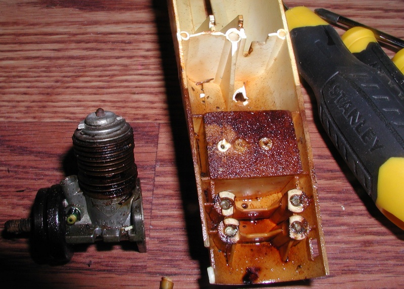

Yes, very fragile. I tried to save the fuel filler nipple but it snapped off when I carefully tried to remove it, even used penetrating oil in the attempt. Oh well, another heated brass tube to insert. I believe the filler tube goes all the way to the bottom of the tank so I will have to be careful not to disturb it. It's also located on the outboard side of the tank.

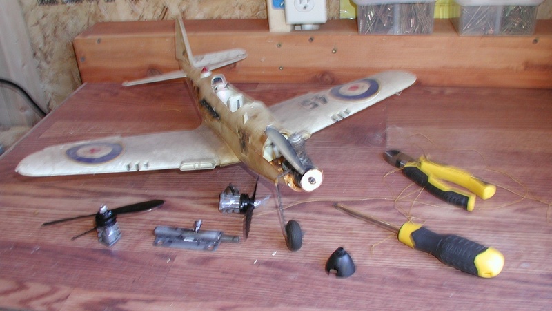

Well, I tried to loosen the motor by using penetrating oil and working the prop. No go, I just broke off the other blade. I was also worried about twisting the con rod off the piston, been there done that.
I know better than to try and remove the wing. Can't be done without breaking it. If you know how, let me in on the secret. I bought one on ebay a couple of years ago and asked the seller NOT to remove the wing. He either didn't see or ignored my request removing the wing and breaking the tabs. Saved him a couple of bucks shipping and cost me an airplane.
I think I can save that elevator.

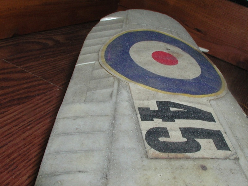

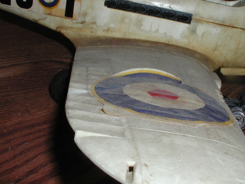

But now that I have it all apart I'm thinking , wouldn't it be nice to remove all the decals, clean it up within an inch of it's rated life, repair all the damage, paint it plastic cote blue, re-decal it, build a canopy out of balsa and put it on the shelf and worship it. Nah, go crash it.
AMF did a good job on this model for all it's faults. Landing gear for example. It is well screwed together and is quite innovative being the only model I have seen with ailerons molded in a constant right turn position keeping it hanging out on the lines without additional tip weight. But I did trash that silly pilot ejection mechanism.

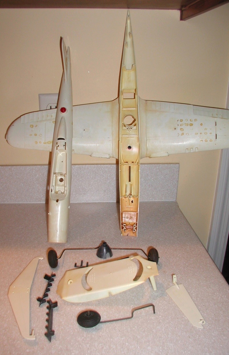

Well, I didn't have much choice if I was ever going to fly this thing, sacrificial or not.
The motor was stuck beyond saving without a full disassembly, the fuel tank was a mess, and there really was not a practical way to fly with half an elevator. Soooo I attacked the sucker.
The decals came off easy, the adhesive not so. Determination, patience, and a gallon or two of Goo-Gone prevailed. Now to address that broken elevator, broken mount for the nose gear, broken fuel tank, and frozen engine (boiling now) then some paint. Anyone ever use that Fusion on plastic? Shows black but it's really Corsair blue. I would like to remove the wing and paint it yellow and the fuselage blue, but I know the tabs would snap off if I did.
Still a step up from this mess.

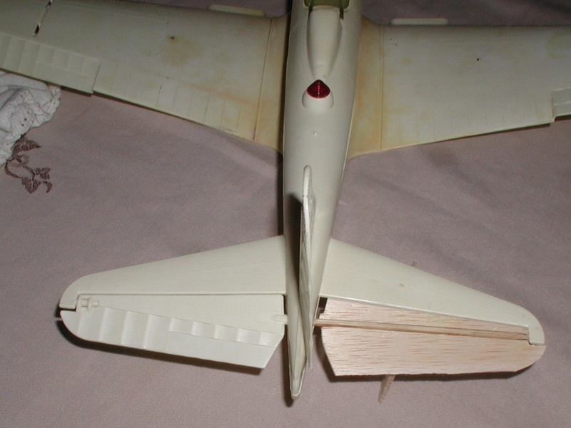

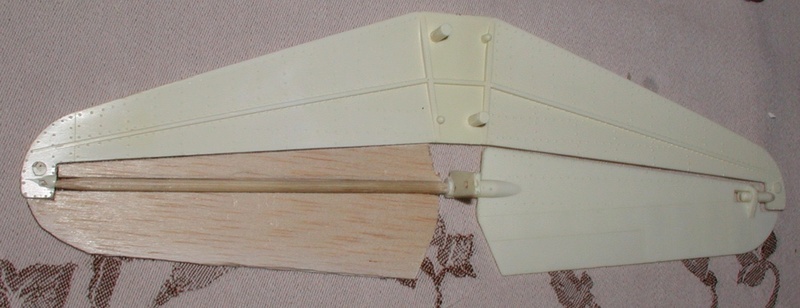

That's crossed my mind Mark, and I'm sure that I have a sheet around the house somewhere laying flat in a place that I will never find it.
But, I have been playing around with something like this:
The right side pin of the horizontal stab is missing but I could drill a hole and insert the tapered end of the bamboo in there and fix the other end somehow to the plastic control. I'm afraid that if I use cloth hinges they would not align with the pivot point of the more centrally located control. Of course I could just shorten the control rod and replace the whole elevator assembly.
Working on it.
Working on it.

@rsv1cox wrote:That's crossed my mind Mark, and I'm sure that I have a sheet around the house somewhere laying flat in a place that I will never find it. But, I have been playing around with something like this:
The right side pin of the horizontal stab is missing but I could drill a hole and insert the tapered end of the bamboo in there and fix the other end somehow to the plastic control. I'm afraid that if I use cloth hinges they would not align with the pivot point of the more centrally located control. Of course I could just shorten the control rod and replace the whole elevator assembly. Working on it.

If I'm seeing your picture correctly you shaped and grafted a piece of plastic onto the right hand side of a broken elevator? If so, you must have used plastic cement and I'm wondering about it's holding ability under stress? It seems that I can see the attachment point just to the right of the pivot. But the plastic so perfectly matches the shape and color of the original I am questioning my eyesight.
Amazing that you could find that striped material so matching the original.
Having nothing else to do I am going to try drilling a small hole where the broken pin was on the stab, then notch (tab A&B) the bamboo/plastic interface and epoxy. I will have to split the balsa and epoxy the bamboo rod down the middle to retain the proper pivot point to match the other side. Or I may just build a whole new elevator, or.........I may just trash it and go drive my MX-5.

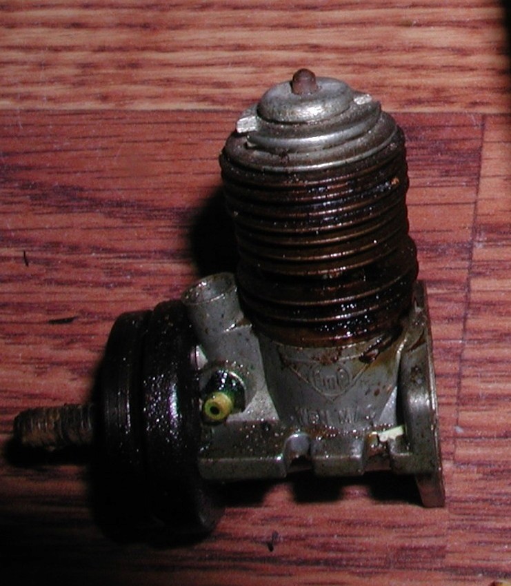

As mentioned I A/F boiled the Wen-Mac motor and it came out great. I followed my adopted procedure (from you I believe) of cleaning it without a full disassembly by removing from the boil, plunging it into a container of Simple Green, cycling it CW & CCW while submerged purging the A/F, then into a container of hot water purging the SG, then a compressed air blow-out, then into a container of alcohol and more CW & CCW, followed by a dousing of RemOil and more CW & CCW. Saves gaskets.
But................ I had removed the severely bent needle, something like 45 degrees. I replaced it in the NVA and attempted to straighten it without heating it first. Paid the price as it snapped off as the expletives flew.
I have replacements but it still gnaws at me!!!!!!!

I am not seeing the bamboo skewer as the method I would use
On the stab out board hinge pivot location that is broken I would carefully drill a tiny hole and push a tee pin through Into the (CA Hardened) Balsa elevator then clip off the exposed portion
I would bend some small diameter music wire into a "U" and epoxy it to the good plastic- and new balsa elevator half, with the U just in front of the center pivot/ horn and probably have to relieve the fuselage pivot opening to accommodate the slightly weird new Balsa side pivot area
Posts : 3435
Re: Sacrificial Wen-Mac Kingcobra
Thanks Fred, I was hoping that you or roddie or someone would chime in with some logic regarding this effort.
Using the smallest drill bit that I had, I did drill a hole in the far end of the stab but with my shaky hands and poor eyesight I managed to hit it slightly off center. I will have to epoxy or JB Weld a reinforcement dot there, insert the pivot with some release agent twist to form a rotational pocket and try again. Something like bedding a .243 on a micro scale. I did hit the other end spot on though tapered the bamboo end and stuck it in for a tight fit. Will fillet it with epoxy let it dry and try to break it loose.
That bamboo is tough stuff. This is a trial effort but I think that it will work. If it doesn't, I will try again with a new effort.

Outboard shaky hand drilling aside...Your method is good... I was not seeing how but now that I see it ----I would actually do that way but with my bag of skewers that have all sorts of sizes and pick a slightly smaller diameter than you are using
Looking good...drive on sir, it is just a sacrificial beater any way....I doubt I would even spend a bunch o time making it perty

@rsv1cox wrote:As mentioned I A/F boiled the Wen-Mac motor and it came out great. I followed my adopted procedure (from you I believe) of cleaning it without a full disassembly by removing from the boil, plunging it into a container of Simple Green, cycling it CW & CCW while submerged purging the A/F, then into a container of hot water purging the SG, then a compressed air blow-out, then into a container of alcohol and more CW & CCW, followed by a dousing of RemOil and more CW & CCW. Saves gaskets.
Stuff happens, been there done that. I bought (bid win) a later Wen Mac .049 like yours. Orifice in spray bar won't clear even in boiling. I pulled the spray bar from the crankcase. Plan to JB weld me another, either an Enya assembly or one from a Sure Start assembly.

This elevator is working out better than expected, so much so that I'm keeping the trial piece. I epoxied the open end tip of the bamboo letting it set a bit before rotating it for a few minutes so it would not glue up. Made a nice little pocket and prevents any end play. I filled in the bamboo/balsa interface with epoxy and made a bushing on the bamboo end duplicating the plastic side. Pretty darn strong and I'm happy with it. Even glued on a filler piece to match the "good" side. Now to sand down and seal with sanding sealer prior to painting.
Kinda rough right now but it will be better.
