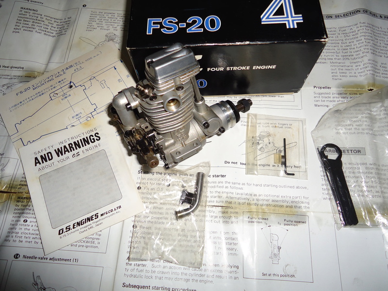

Hi everyone, I have several projects in mind, I decided to ask if anyone of you ever ARM the ACE R / C ALL STAR ??.
I plan to use a .20 FS 4T OS for this model.
I took these two photos of the internet to graph the engine and the model of which I speak.
Any experience?
I will see which model (project) I decide! ??Paranoid

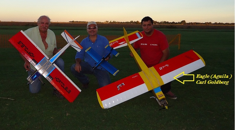

Hello Roddie, my friend, so you have it as a project too.
If you do not have experience in Radio Control, take some time with a coach and in a couple of months you will fly !, you have to have a model to learn and an instructor who has the will to teach you and above all else.
There you have a coach that I would say, has traveled the world, is the Eagle II by Carl Goldberg, a phenomenal model, quiet and very docile to learn to fly.
Incidentally one of my friends is learning and in his hands has the Eagle II.
Returning to the All Star model, I have a .10 FP OS, it is a very noble engine, it works very well in all ranges, so it is appropriate to place a biplane in a reliable engine, since they are more critical at the time Of the glide in case the engine stops - stop.
Do you plan to do it 4 channels?, Ideally would put ailerons! ...

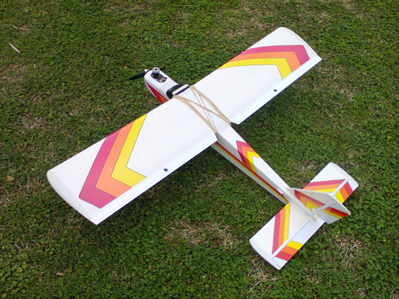

Model AMA PT 0.010, originally does not have ailerons, I incorporate them.
All Star Bip R/C - ACE -R/C Dsc02038

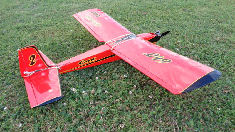

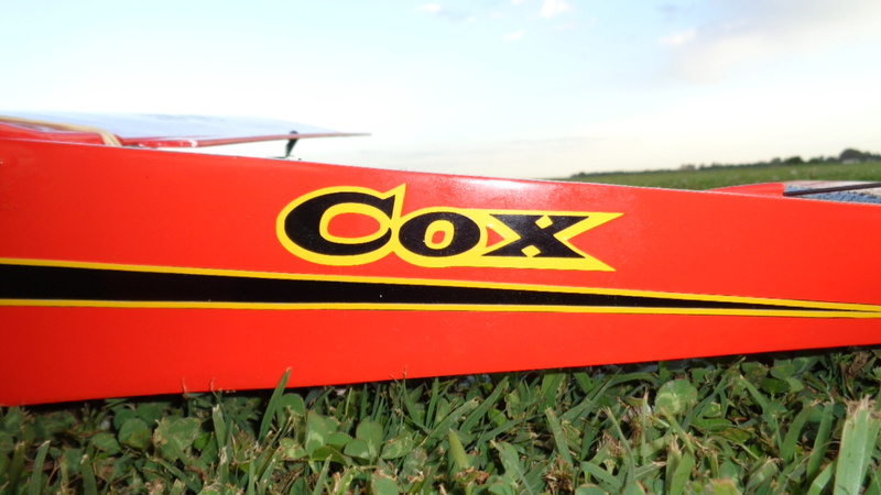

Model AMA PT 0.020, originally does not bring spoilers, I incorporate them.All Star Bip R/C - ACE -R/C Fhd00010
Model Baronnet refurbished 0.020, originally does not bring spoilers, I incorporate them.All Star Bip R/C - ACE -R/C Dsc02122
Model Baronnet refurbished 0.049, originally does not bring spoilers, I incorporate them.All Star Bip R/C - ACE -R/C Dsc02322

Thanks Mark for your message, it is very encouraging.
Look, a few years ago I set up a model of the US firm Great Electric Plans. It is an incredible biplane to enjoy and learn.
Here I am flying, I leave a video:

This is my OS .20 FS engine, I'm studying it a little and I'm surprised by its weight, 265 grs.! I also discover the following, if I can explain, I notice that some engines .20 FS 4T, bring the muffler with pressurizer and others (like mine) only bring the exhaust outlet pipe there is no pressurizer.
I thought it had gone astray, since I bought it from a colleague, it is new, it has never been started, so I look at the manual and there in the photo there is no silencer with pressurizer, even the instructions of the tank assembly , Leave the tank air inlet, free, ie without pressurizing.
It has a nipple in the cover of the carter that according to the instructions are of ventilation, and says dejaro free with a tube of neoprene.
If anyone has this engine, I would like to know if there are two versions, without muffler and with muffler plus pressurizer .... Shocked Paranoid Huh...
All Star Bip R/C - ACE -R/C Dsc02410
All Star Bip R/C - ACE -R/C Dsc02326

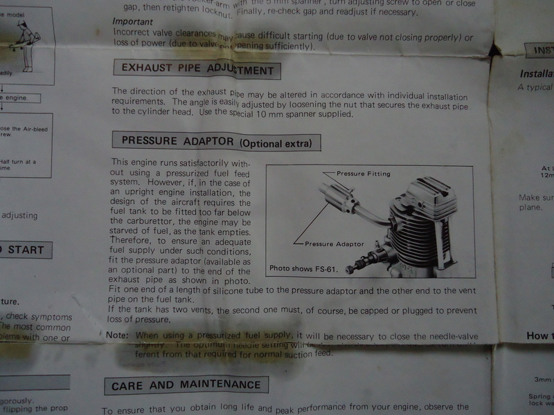

Here in these instructions you can see that the manufacturer indicates letting the air inlet pipe free, ie the engine works without pressurizing .... I'm really surprised:
All Star Bip R/C - ACE -R/C Dsc02325
In this picture, the manual is deteriorated, but it indicates that the nipple of ventilation of the carter must be free, that is to say with exit to the exterior of the fuselage.
I wonder if it is possible to use it to send pressure to the tank?All Star Bip R/C - ACE -R/C Dsc02324All Star Bip R/C - ACE -R/C Dsc02327

Now I read in the manual that the silencer and pressurizer system, is an optional part !, does not come with the engine .. At least that's what my manual says! Crying or Very sad
Eh taken two images of the web to indicate the difference:All Star Bip R/C - ACE -R/C P8280010
