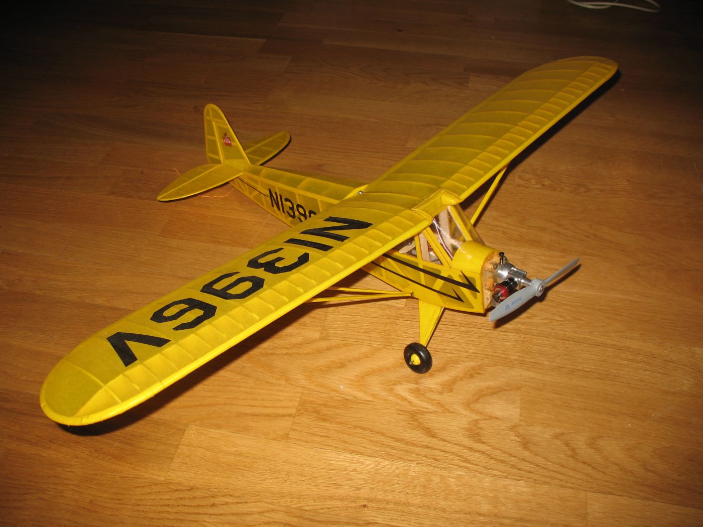

Most ARFs that are in a suitable size are usually made from foam. I think that it is much easier to find a kit or a drawing for a suitable plane in this size. The build is very fast anyway and it is a lot more fun to build them from scratch rather than trying to fix an ARF that was poorly glued together from the factory...
Here is a J3 cub (laser cut kit) that I "converted" to glow and diesel using a cox .020, total weight is around 125g;

Surfer_kris wrote:Here is a J3 cub (laser cut kit) that I "converted" to glow and diesel using a cox .020, total weight is around 125g;
HELP! Looking for a ARF R/C plane that uses a COX 049 or 020 Img_1218
Nice looking kit conversion build, With the .020 Pee Wee, I bet it flies like a dream come true. Smoking RC Plane
