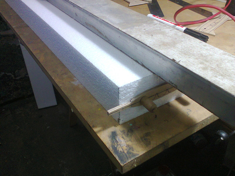

This time I decided to make a wing in foam plated in raft.
About 20 years ago, it manufactures an adjustable source with a nicron arc, precisely to cut telgopor - foam.
Then start the templates to squared the foam and cut the wings ....
Posts : 772
Age : 46
View user profile
Re: Idea of a model for Cox Tee Dee 0.051 and ...Medallion 0.049!
Post  MauricioB on Wed Jun 21, 2017 3:51 pm
Made the measurements and already squaring the piece of foam, start to cut by the lines, the back of the cut are those pieces squares embedded in the foam ....

Great job!! I've never done that hot wire thing but you seem to get along well with that. very cool.

The wing looks great so far.
Is there any particular reason for using white glue instead of epoxy?

Beautiful work....What foam did you use for the cores? High density styrofoam?

Post  MauricioB on Thu Jun 22, 2017 6:41 am
OVERLORD wrote:Great job!! I've never done that hot wire thing but you seem to get along well with that. very cool.
Thank you! ... you have to try the ideal temperature point of the wire and then it comes to practice. Smile

Post  MauricioB on Thu Jun 22, 2017 6:48 am
Surfer_kris wrote:The wing looks great so far.
Thank you! ... Yes, the use of glue "carpenter's glue" instead of epoxy has many advantages, it is very easy to apply, and when the curing begins, it begins to evaporate the excess, leaving only the necessary between the parts to paste , Is extremely strong and while you do the work you have time to move as many times as you need until you are sure of the correct location of the parts.
If you use epoxy, all the material you put there, will remain and will not evaporate, therefore generating an extra weight.
Make me friend that the carpenter's tail is an extraordinary and old glue checked its result.
The epoxy glue used only to glue the center of wings, to "fill even some extra pore between the parts.

micro 0951 wrote:Beautiful work....What foam did you use for the cores? High density styrofoam?
Many thanks !, the foam here known as telgopor, the one I am using is medium density.
According to the merchant these are the characteristics:
Low density (common) = 11 kg / m3
Medium density = 20 kg / m3 (this is the one I am using in this work) Thumbs Up
