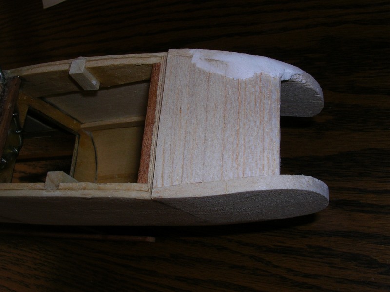

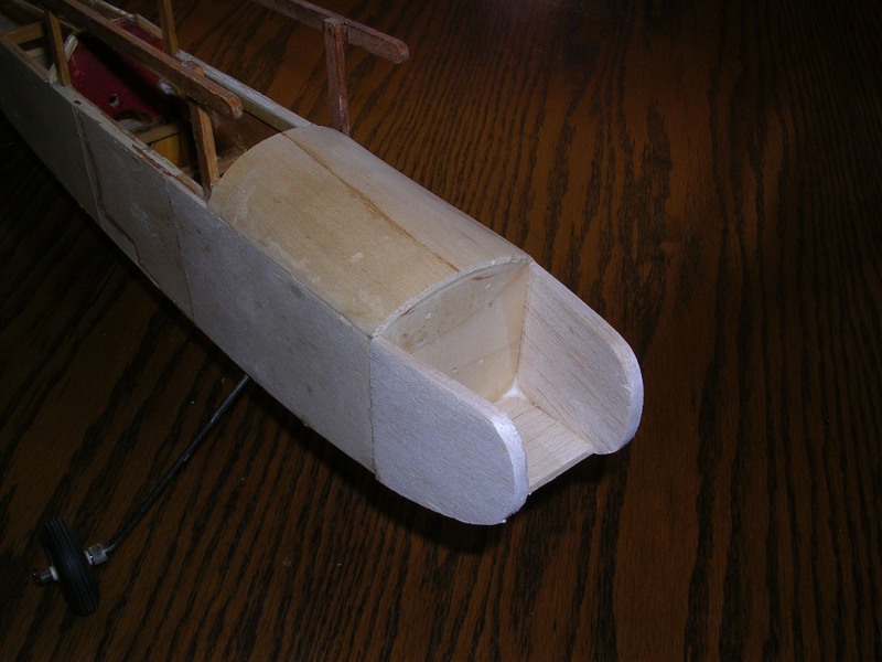

Jim, the repair can look as good as new if one wants to put in a little extra effort. This is my Q-Tee, nose was shattered from a Figure-9, direct hit on the nose. Following is a summary of how I approached repair thereof.
Ordered a 1/2A Skyray kit - Page 6 Q-tee_12
Fuselage with broken nose parts removed.
Ordered a 1/2A Skyray kit - Page 6 Q-tee_13
Patterns photocopied from plans.
Ordered a 1/2A Skyray kit - Page 6 Q-tee_14
Damaged fuselage front cut away.
Ordered a 1/2A Skyray kit - Page 6 Q-tee_15
Fuselage splicing backer glued in place.
Ordered a 1/2A Skyray kit - Page 6 Q-tee_16
Front fuselage sheet panel and a new cabane strut upright installed.
Ordered a 1/2A Skyray kit - Page 6 Q-tee_17
Rebuilt battery compartment, lightweight synthetic spackling fills imperfections.
Ordered a 1/2A Skyray kit - Page 6 Q-tee_18
Fuselage nose rough sanded.
Ordered a 1/2A Skyray kit - Page 6 Q-tee_19
New wing cabane rest Epoxied in.
Ordered a 1/2A Skyray kit - Page 6 Q-tee_20
Norvel Big Mig .061 with tank mounted in nose.
The repaired plane looks good as new, no one would ever suspect it was wrecked.
