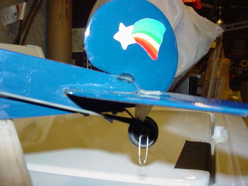

Then there's the "safety-pin".. (inventor Walter Hunt-U.S. Patent# 6281 dated 1849) spring-steel with a perfectly-formed "eye-coil".. on one-end.. and a protective "clasp-closure" on the other end. Available in many sizes from tiny.. to large.
Aero-Modeling uses include (but certainly not limited to..) pushrod guides (with clasp-portion cut-off.. and legs imbedded/glued into structure), fair-leads/thimbles...
control-line lead-out eyelets/guides..
or even a quickie-link for a C/L pin-stooge..

Using a safety pin for a lead-out guide is a great idea.

They're also an excellent source for a pushrod-guide. The "clasp-end" of a small safety-pin (with pin latched) can be imbedded and glued into a pocket in the fuse-side. The clasp by design; makes an excellent anchor with the glue. Once installed and the glue cures.. it's not going to pull-out without taking the surrounding wood with it. The two legs of the pin assure that the "eye" stays perpendicular to the pushrod. Installation could be as quick as jabbing the appropriate-size flat-blade into the soft balsawood to form the pocket. Apply glue to the clasp.. put a little in the pocket.. push the clasp into the pocket and wipe-off the excess glue with a tissue.
