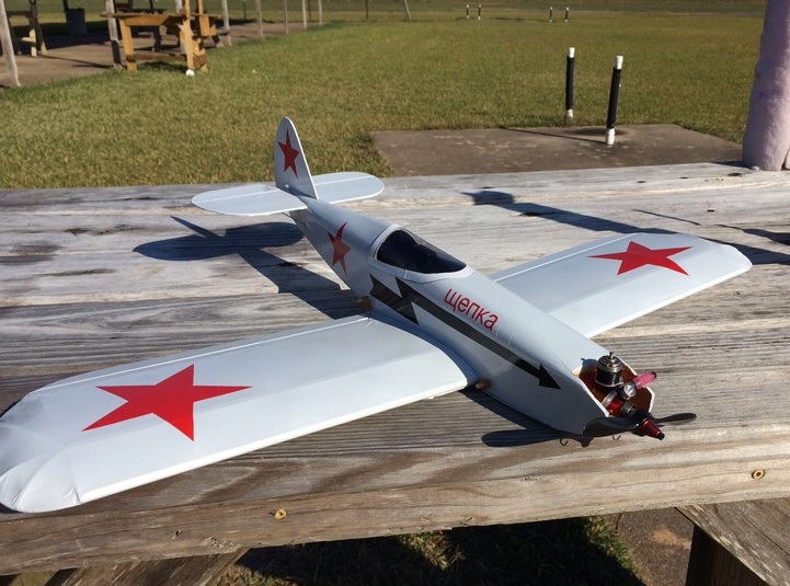

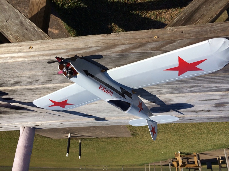

Post  Tee Bee Mon Nov 27, 2017 10:04 am
Guess what I've been doing. RC Plane
The Sliver - a TD .020 Project - Page 3 Image59
The Sliver - a TD .020 Project - Page 3 Image58

Post  MauricioB Tue Nov 28, 2017 12:04 am
Tee Bee wrote:Guess what I've been doing. RC Plane
Hey Tee Bee, what a beautiful postcard: the model next to you, in what seems to be a beautiful day!
I am happy to know that the model is going very well and that the engine works perfectly ... now comes the throttle adjustment part, I will be attentive to your progress and when you can place a video, I would love to see that wonder in action! cheers
