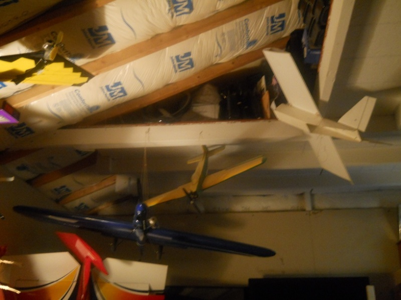

Here is a pic of my Tee Dee .049 powered rc plane hanging in my shop. It's just a simple scratch built low winger with 2 channels, elevator and ailerons. Sorry for low quality picture.

Post  dirk gently Mon May 27, 2013 5:21 am
These are two really nice planes, the low wing, and the white V-tail.
Do you have any more data (wingspan, weight, etc) or photos?

Post  sdjjadk Mon May 27, 2013 10:54 pm
dirk gently wrote:These are two really nice planes, the low wing, and the white V-tail.
Thanks dirk. Smile
The white v-tail is one of those coroplast combat S.P.A.D.S. for a .15. The wing is made from 2mil and 3mil coroplast and uses a cut down wooden yardstick for the wing spar, 3" square Canadian gutter pipe fuse and it has a plexiglass firewall as well. Search google for spad to the bone for more info. The square fuse was from an old combat plane that I flown probably a hundred times and needed a new wing and tail so I folded up a new wing and made a new v-tail. It's not finished yet but it will be after I finish my other projects. And I'll take more pics of the yellow plane and try and get a weight for you as well. It was scratch built with no plans with a few ideas from looking at a few pictures here and there. I'm also getting into cutting my own foam wing cores and made a wing for a scratch built .020 powered Stick project. I still have to add a balsa leading and trailing edge and sheet it with balsa skins.

Post  dirk gently Tue May 28, 2013 7:39 am
Great, thanks for the reply!
How about the yellow-green low-wing?
