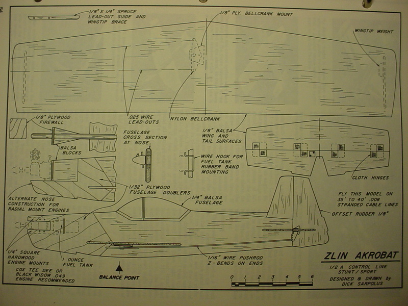

Congrats Phil!! That looks like a nice flying little model. The vid posted by Rod mentions it being designed by Dick Sarpolus. I have a plan for his "Zlin Akrobat".. a 1/2A version of Sig's model which came from his book; Building and Flying Control Line Model Aircraft. It's one I'd personally like to build someday. It's a 29.5" span profile/sheet-wing design for Tee Dee .049/.051 power.. or similar.
