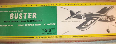

Post  batjac Sat Jan 06, 2018 8:02 pm
Stop The Presses!!!
I forgot about this the first time I posted here, but I remembered a few minutes ago.  If you look at the pics of the SIG Buster on the page I posted, there are two pictures of the Buster kit box.  The first picture has the same yellow starred border around a teal background.  The wording on the label is identical except that it says "Buster" instead of "Shoestring" as Mark's box does.  This would show that they are of the same vintage.  They were both produced at the same time for club racing, and designed by the same designer, Mike Stott.  The Buster is kit CL-12 and the Shoestring is CL-13
shoestring untied Image
The cover picture on the Buster kit box clearly shows the model with a Cox .15 engine on it.  Mystery solved.  Mark's Shoestring needs a Cox .15 on it!

I certainly won't dispute the box art. I just wouldn't assume the box art is the engine of choice. Even today, I know some who build for the designer and rarely fly the models themselves. The Sig kits were  event designed  kits around .15's like the Fox and Super Tigers. The Sig kits were designed  for the slant plug .15's. Goodyear events from coast to coast evolved into what the guys located in certain areas desired. There were generally 2 classes of .15 Goodyear A&B class or 1&2 which one of them being high performance and the other low performance entry level events.  I don't know if the builder just desires certain nostalgia. I have been involved with .15 sized racing events since the mid eighties and I never witnessed one of these planes with a Cox Medallion or TD .15 on the nose. Not saying it's not a formidable choice or couldn't be used.  Of the Cox engines  used, it was the Conquest in glow or converted to diesel.  Seeing the planes design was simple and the easy availability of the Fox, it made it a hands down choice for entry level racers wanting to try their hands at racing. For the most part, it was a smaller version of Foxberg racing with a slightly different set of rules.

Post  batjac Sun Jan 07, 2018 1:24 pm
I got a reply from the owner of the SIG history site.  He agrees that it was flown with a Fox.  Ah, well.  I tried for a Cox engine...
Hi Mark!  I'm glad you like the website - it's been a lot of fun putting it together over the years.  1975 was the year that the CL-13 Shoestring was introduced by SIG.  It's widely believed that the prototype flew with a Fox .15 and 6X4 prop.  My own flies with a un-muffled Fox .15 and 6X6 prop (yeah, I'm lucky in that I fly on a field that's far away enough from people).
Just a note here - the Cox Conquest .15 (being that you're in the Cox Engine forum) would definitely be of the right time period also but IMHO it might overpower the Shoestring.  Would be fun watching/hearing one in the air though.
