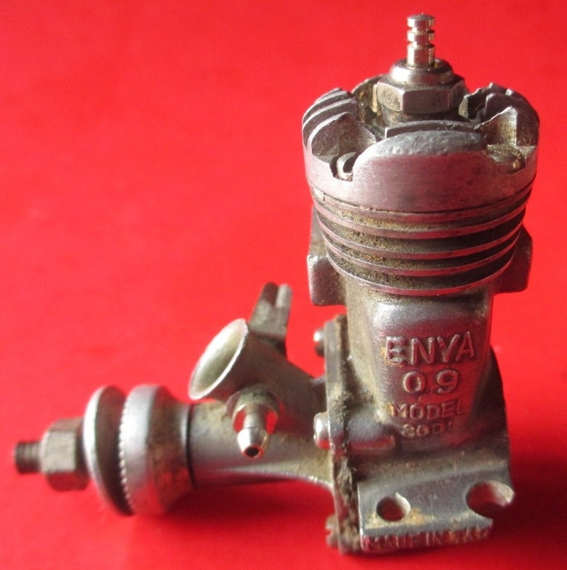

Edit: I just picked up it's Enya ugly brother on ebay. Maybe I could mount in in the body and drive a set of wheels with it. Seems it would fit right in.

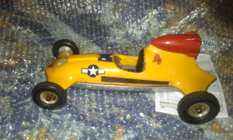

Re: Grab your torches and pitchforks!
Looks like you have a winner Eric, Air Force markings and all.
Ok, I'll clean the engine well (inside) and we will race doing timed laps. You will do yours in seconds, mine may take minutes.
I did not hear from the seller regards history of the little bugger, didn't really expect to. Maybe he will only get four stars out of five....
EDIT ADD................Heard form the seller....SHE will get five stars out of five....

I see the FUN has arrived , man she does look alittle rough with close ups of the engine but i am sure runable . They are heavier than you would think , i know when i got mine , was what i was thinking and mine dont have a engine on it . I will have to go over to the school to run mine = maybe some kids will show up to watch the FUN !
Posts : 8826
That's an early Babe Bee Bob. The large-diameter knob on the needle, thin-wall cylinder and the shape of the crankcase nose are indicators. You might want to check if it has a three-piece piston.
Replacing that worn prop is a good idea. It also looks to me like it's a tractor.. and facing rearward. Just remember; if using a "tractor".. the prop should face "forward".. just like on a conventional airplane application and you'll need to crank the engine "clockwise".. as if it had a L/H starter-spring on it. Am I making sense? It's reversed because the engine is facing rearward. Of course.. you could use a "pusher" prop if you had one.

It’s hard to tell but looks like lettering on the tank and the color if the backplate looks too dark for it to be a first issue babe bee. It’s probably a 58 or so.
Yes, an early engine. It has Thimble Drome stamped on the case, but I forget if that is an early engine indicator or not or if the stamping came later?
The engine mount looks like something an adult would construct, well engineered and applied. But the red tape on the prop is something that looks like a kid did. The cage looks like a clothes hanger wrapped in fabric medical adhesive tape. Nicely formed and applied to the body, not an easy thing to do.
Mismatched body screws, only two look original. I'm sure I have better replacements. I'm still debating if I should remove and clean the engine mount and engine, or leave the mount in place and just do the engine. The other option is running one of my other Babe Bees.

Ok, so which predates which, Thimble Drome stamped fuel tank or unstamped? I have always believed that the stamped fuel tank came first and was eliminated later for cost and/or faster production purposes.
And, it would seem that an unsecured loop on the tether connection to the bridle would result in finding the best position for a circular run. It's all wrapped up in higher math and well beyond me regarding which leg should be shorter or longer. Kelly Johnson would "cut and try."
