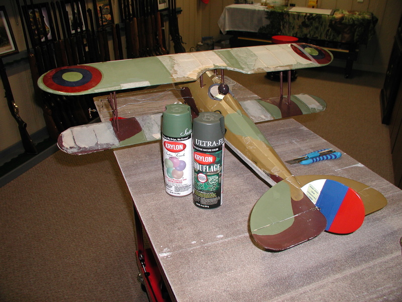

But I was desperate.
Flat out of thinner and very little clear dope to patch up this poorly finished second model N-28 for a potential bucket list crash and burn circle around sometime in May hopefully with some of my CEF buds I resorted to using products on hand. Whew, big breath.
Pictures tell the story............

Hi Bob,
I get using what is on hand...very respectble repair too!
Any plans on fuel proofing? To what extent?

Bob, the glue method is quite popular. Yellow carpenters glue however can make it a brittle. White Elmer's glue is all I ever used early on. Thin it to the consistency of milk and apply. Nothing wrong with that whatsoever. I use that method with all of my free flight stuff as well. It can also be doped over once dry with no problems. The main problem is the water in the glue can warp surfaces so using caution is important. The other is that it can shine at a lap joint or repair when the finish is applied so keeping your repairs at a natural break is most helpful. Many times I covered sheeted foam wings initially because I didn't want thinned down dope to run into a crevice and melt the foam so the glue method worked well for the attachment coat, after that I went to dope.

I used the same white glue to attach the silkspan that came with the Sig and Comet kits back in the day. Warping was always a concern. Mist the silkspan damp then shrink dry. I liked the Comet x rib kits. The wing ribs formed an x. The wings were strong and tended to to warp as easy. I believe these also had a tube down the fuse for the rubber band. If the rubber band broke you didn’t end up with tooth picks when the fuse exploded.

Yes, my first thought was white glue and I was going to put it on my shopping list. Then I remembered that I had Titebond and Elmers carpenters glue and used that. The Titebond was out in the garage frozen so I used the house-borne Elmers.
I was surprised how well it worked. Shrunk up nice and tight with a little more backbone than water alone. My usual is laying it on wet, then painting the edges with gloss clear or dry and clear the edges then spritz.
I don't give a hoot as to what it looks like, it needs a complete fabric strip and redo. I will probably crash it anyway. But I may just over-spray the repairs with the camouflage paints shown without any primer prep.

So, is Krylon fuel-proof? I heard Rust-Oleum is as long as it is given sufficient cure time...like to weeks.

Don't know about Krylon being fuel proof. I just sprayed some on the top wing to see if it would eat the glue.
Doesn't seem to, but it sure brings out the flaws. But ugly is only surface deep, the airframe itself is quite strong and well done.

Back when I did a bunch of Core House foam wing based models, I learned the Elmer's... wood type glues were, by them selves, fairly fuel proof and once dried took readily to a wide variety of over coatings
One characteristic I like...once dry.... many of the wood glues sand very well
Another cool feature is most of the Elmer's types are OK with heat activation... I have so far resisted deliberately buying ModgPodge craft store glues....but many folks report it is good for laying down some coverings

Hello Bob, from what I understand when reading You use a type of glue (carpenter's glue we say here) ... why do not you use DOPE?
My models with paper always use DOPE, then synthetic paint, all that perfectly recipes the fuel .... (maybe I did not understand the talk and description)

MauricioB wrote:Hello Bob, from what I understand when reading You use a type of glue (carpenter's glue we say here) ... why do not you use DOPE?
My models with paper always use DOPE, then synthetic paint, all that perfectly recipes the fuel .... (maybe I did not understand the talk and description)![]()
I was out of dope and thinner Mauricio so I resorted to using what I had on hand. So far the glue/water mixture is doing fine.
