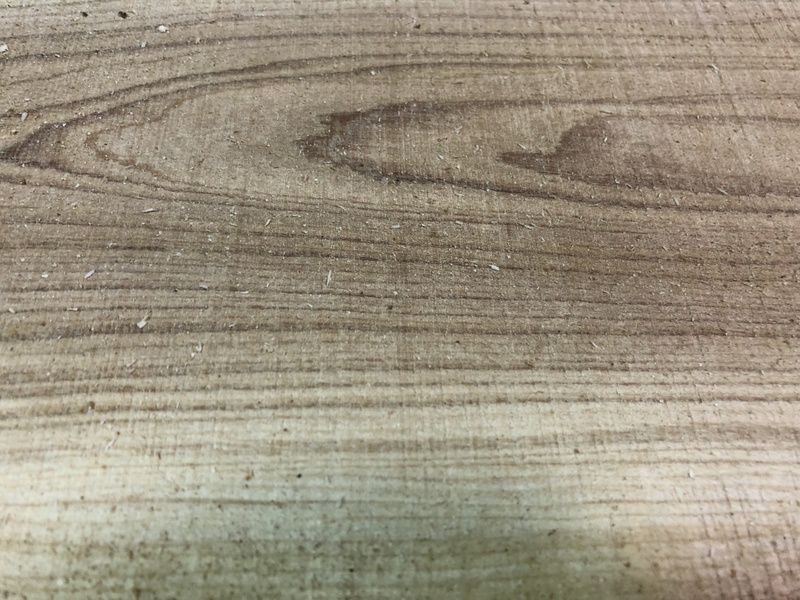

just throwing this out there.. Old wooden side-rails from a bed-frame are often thrown out. They're a great source of hardwood for making engine-bearers. One rail would yield a lifetime of beam-stock. Often found in maple, cherry, oak.. etc. It doesn't take much room to store a rail until you need it. They're also warp-resistant, due to the nature of their construction.
Re: hardwood source
That one looks to be veneer in the pic. Can see the lamination on the side grain edge.

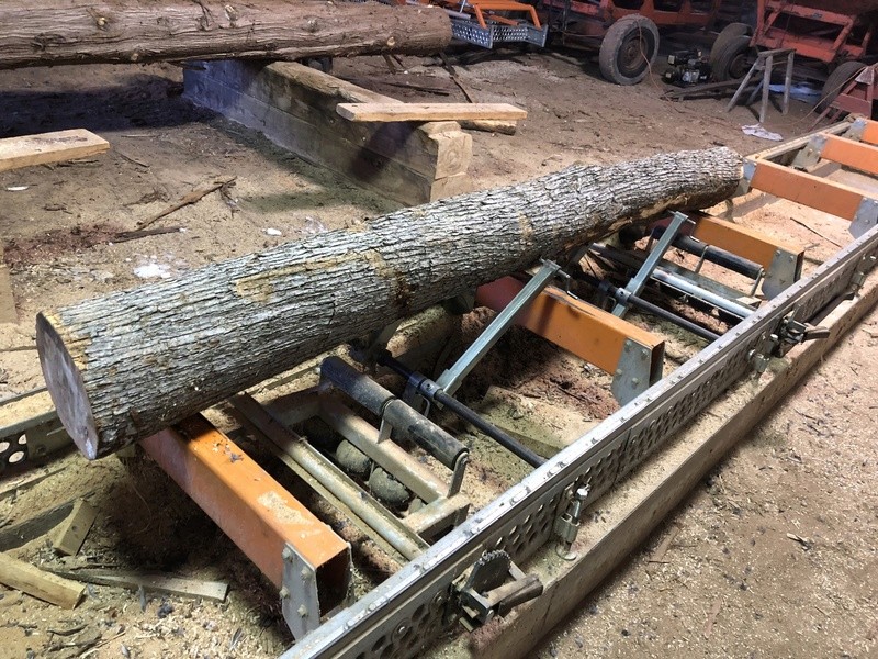

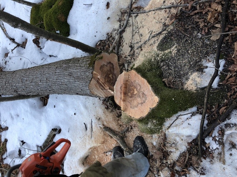

I was able to cut the ironwood today. From tree to lumber in an hour.
Found a growing tree in the woods. Cut it down and then cut to length. I cut it at 9’ long.
Get it on the mill and cut into boards. The growth rings vary from 1/16” to 1/8”.
The sawmill has a Honda 20hp V twin on it. When cutting the ironwood which isn’t very big it makes the Honda grunt. This stuff is hard and dense.
Then the lumber needs to be edged on both sides. I have a twin blade edger that has a movable blade. Set the width then run the flitch through and end up with a board.
Stack and sticker. Ended up with 45 board feet. Lots of engine bearers.

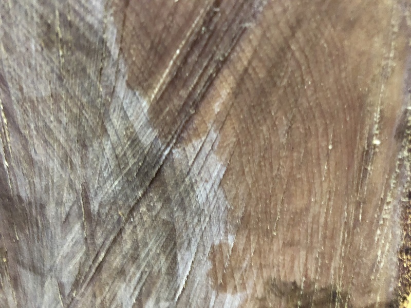

Ok guys the ironwood had been stickered and air dried for almost a year. Time to plane them up and get them cut in strips or sell as a short plank to cut your self.
What are the sizes I need to plane the boards to? They are currently at a full 1 inch. I can easily get 3/4" x 3/4" if needed for those .60 size CL planes
This stuff could be tapped for threads its that hard. Fingernail doesn't make a dent.
