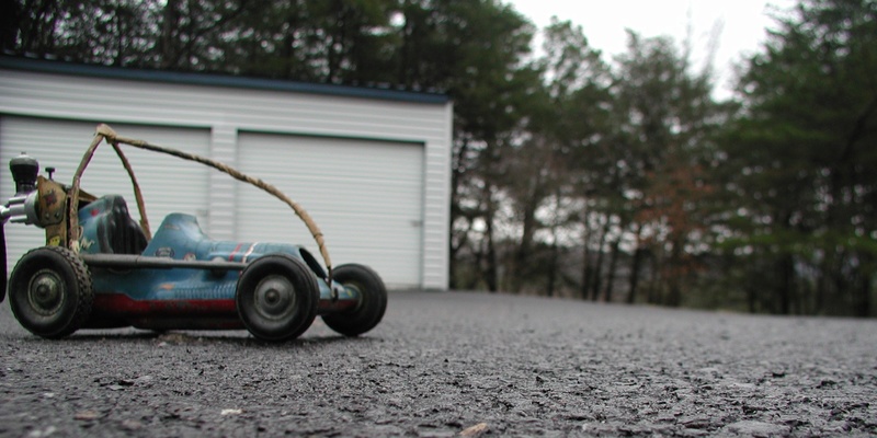

Ok, up-front. It didn't go so well.
Fueled up the tether car, attached the fire, primed and it started first flip. No kidding. Running rich I leaned it out and noticed the engine was vibrating. I have this habit of not tightening my engine case bolts when putting them away for storage.
It was difficult getting those little 2/56's in right the first time anyway and my fingers shake, but I did get the engine off. I did not want to disassemble the whole car again and have to remove the engine mount so I just used the top two screws to re-secure the engine to the mount as the bottom two are impossible to get at. Tight enough for a test run.
Brought everything out to the driveway and drove a pivot nail in the asphalt. This time the darn thing would not start. After 15 minutes of frustration I finally got out the 1/2A starter and got it started running great, and in the right direction. Leaned it out to slightly rich and let it go after pointing the nose out of the circle.
Traveling medium slow it got out 180 degrees to the high side of the driveway (slight slope) and came back towards me finding the tether and wrapping it around the engine shutting it down. No damage.
Future runs I will lean the engine out to max thrust and start from the high side of the driveway down.
Kind of more fun than I thought it would be.

Hey Bob.. a little test you could try for running the tether. Wipe/clean the front tires.. and wrap some cello-tape around the tread.. (a couple of wraps) This will allow the front-end to loosen-up or "float" while tracking the circle. If you find that the car runs faster.. the nose may need to be pointed "in" to lessen friction. You can adjust the bridle/tether to compensate for this. It's like dialing-in the "caster-angle"....... except you're applying it to the chassis.

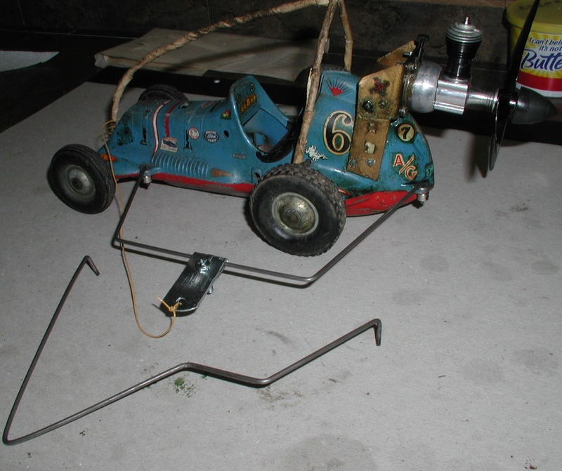

I'm going to construct a new bridle, instead of terminating in a V the new one will resemble a U with a pinchable clasp that I can slide back and forth to obtain the correct position for a circular run. It might get it under control and save me making a bunch of trial bridles.
Posts : 9699
Re: Cox Tether car - re-calculating
It took me about half an hour to knock one out.
Pinch nut and bolt locks down tight but allows adjustment when loosened. Got about 4 1/2" of play. If that doesn't work I will have to go after a different angle making a bridle with a longer front leg. Any trig/geometry centrifugal force majors want to help me out........ As is I can achieve parallel balance but there are other forces in play here so really it's cut and try.

New adjustable bridle was just the ticket
