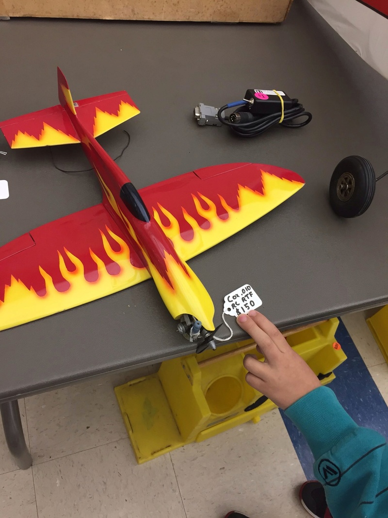

My friend who knows my passion for Cox-powered models went to a swap meet this weekend(I am working long hours, as usual.). This morning, he texted me a pic of this mean little .010-powered beast. I told him to buy it on my behalf. It is now on it's way across Texas to it's excited new owner. We think it is a Micro Estrellita built from a JM Glaskraft kit. According to my friend, it has antiquated RC gear installed and will need to be retrofitted with new stuff. I can't wait to get my hands on it, weigh it, and start working it over. If anyone here has experience with these small racers, I'd be interested in what others have used regarding control throw setup. Ole' 1/2A Nut is already dreaming of me trying custom speed props and upgrading to a Big Block .020 but I'm curious to try it in sport mode with the .010 and a stock prop, at least until it's airborne quirks have been resolved. I believe it has a 17" span.

Drooling x2! That's a HOT looking little airplane Troy! It will be interesting to see what it has for radio gear. I'm sure that you'll be able to trim some significant weight.. if the existing gear is as old as your friend noted.. especially with the receiver battery. Good luck and congrats!

By the way, this is the poc my friend sent me this morning and all that I needed to see to tell him to buy it for me.

I like the flames, kinda unusual for a model. Cool find.

Yeah, looks fast just sitting there!

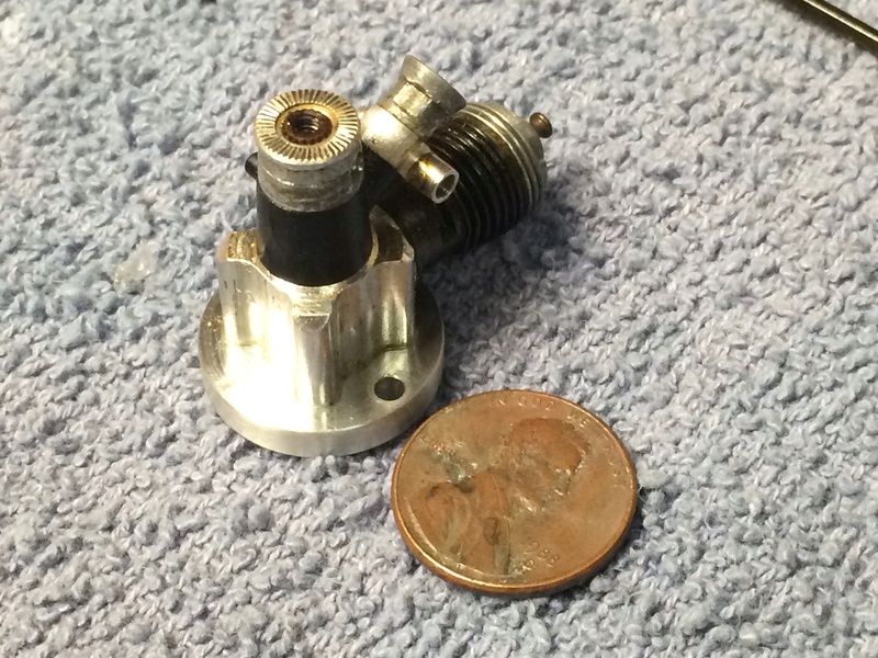

Thanks! After removing and oiling the .010, it turned over very nicely with a solid compression pop. The plane has what appears to be an eyedrop bottle fuel tank. The old 72MHz radio gear is all glued in place and will require some careful prying to replace. Weight as purchased is 4.71oz on commercial lab scales. Time to start prying stuff out.

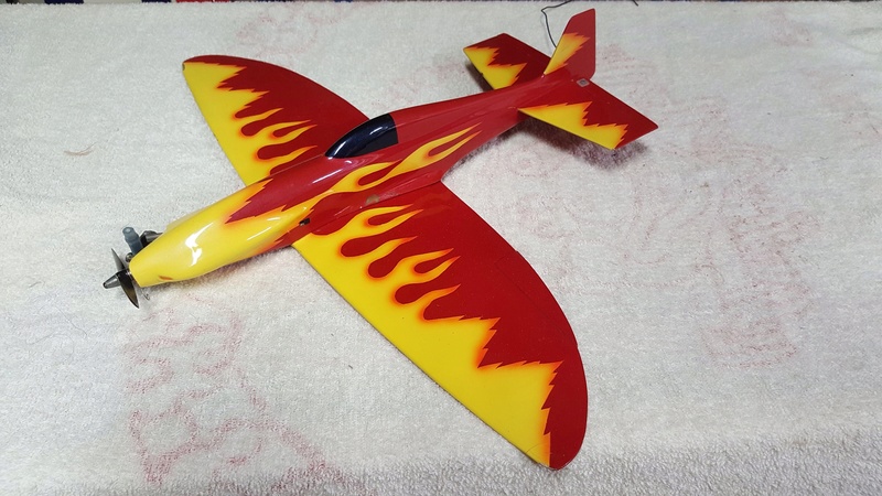

Since aquiring the little airplane, I've learned that it is actually a Micro Shark instead of a Micro Estrellita. That explains the difference in the tail design. It is essentially a Pee Wee Penetrator fuselage with a Micro Estrellita wing. I've corresponded with the original owner and he says he built it around 2002 on a dare from a friend who said it would never be flyable. He then flew it a handful of times over the next year or so to give it some validation, saying it was pretty touchy and susceptable to wind gusts. Warned me to only fly it in calm air and not to blink! I think part of the problem may have been restricted aileron deflection. It is mechanically limited to very small throws by the installation. The radio gear is currently being upgraded from 72Mhz to 2.4Mhz Spektrum. A new 170mah NiMH pack has arrived to replace the old crusty NiCd cells that were still in it. The TD .010 appears to be in great condition and has now been upgraded from the OEM plastic backplate to a nice aluminum unit. The thinner aluminum mount required fabrication of a plastic spacer/shim to keep the prop clear of the cowling. There are still a few cosmetic flaws I want to touch up. I'm leaving town for vacation this weekend but looking forward to further progress and engine testing when I get back. Stay tuned...

I love it. That penny really puts it in perspective. Did you ever get a weight on it? I might have missed it.

Thanks, Rusty. She weighed 4.7oz as previously equipped. I'm hoping to shave a few grams off that with newer hardware onboard.

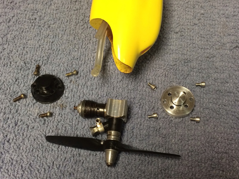

She's getting closer to flying. I was able to do some engine testing/tuning today. The old .010 that came on it just wouldn't run for some reason. I had disassembled it, inspecting everything including the fuel passages. After getting frustrated with it, I finally switched out the aluminum backplate to an older gold case engine that I restored last year. After a few minutes of fiddling, she was running pretty good. With the new radio gear and battery installed, she's gone from 4.7 to 4.5oz weight. Not much lighter but better peace of mind. Our winds are howling every day on the TX coast right now and I've got a lot of overtime on the work schedule. Hoping to get this thing dialed in before the trip to SMALL next month.

Gold case engines where better made, what's the inside look like with the new gear?
