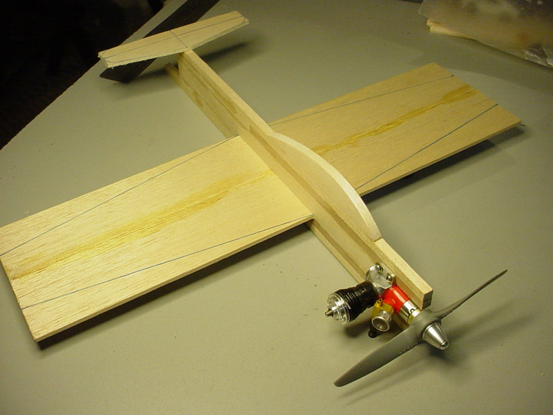

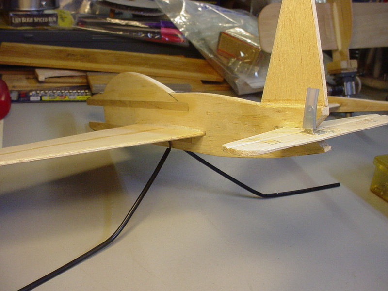

"2018".. repaired kitty-damage and devised a tricycle-gear where the model had originally been designed for a dolly..
Fast-forward to "today".. where I prepped for a coat of primer..

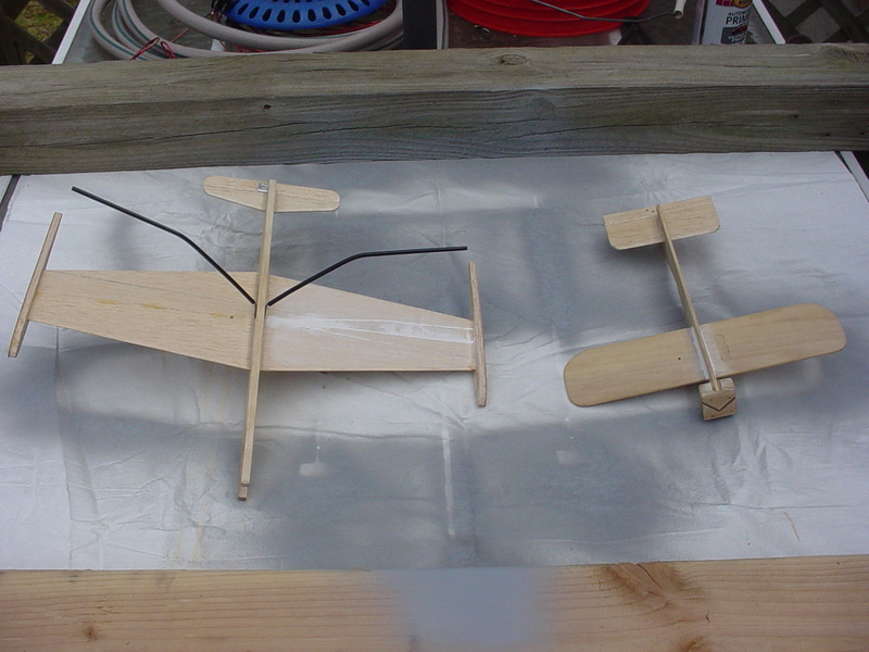

I used coffee-stirrer straws to mask the landing-gear struts.
.. seen here with a much-smaller "reed-valve class" CEF Speed-Contest model; "Flying Blind".. Today's weather here in Northern Rhode Island was mild enough to do some painting outdoors!

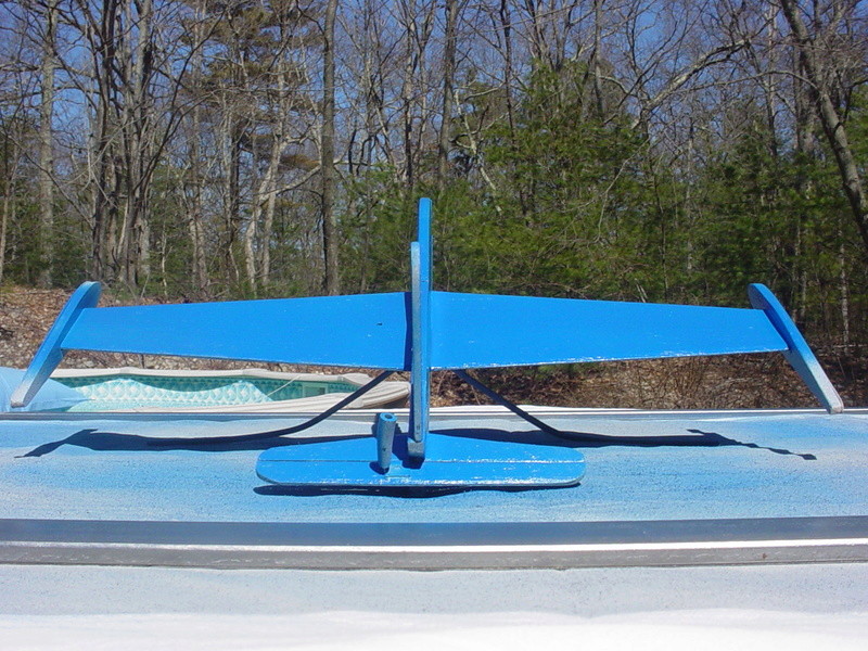

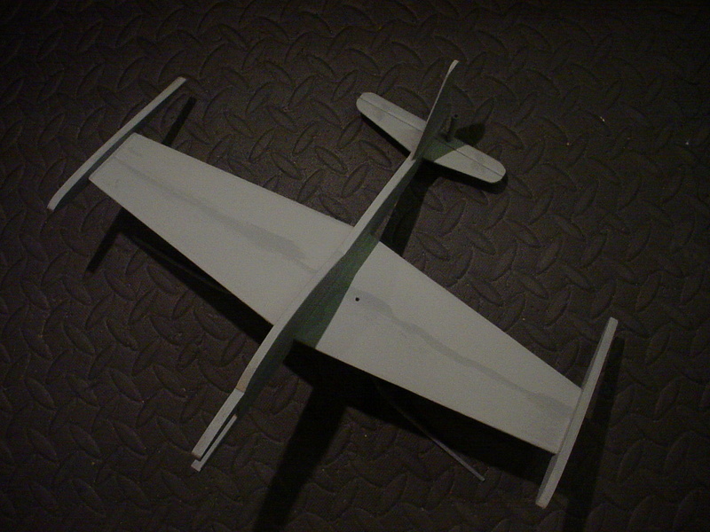

1st base color coat
Beautiful early-Spring day in Northern Rhode Island! The temperature is 59 degrees F. and it's fairly calm. I sprayed my 1st base color coat on the Shooting-Star.
This is planned to be a "Blue Angels" version. The yellow trim color will be brushed-on.

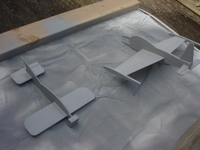

While this 1st coat is setting-up.. I'm prepping two other models for their 1st base color coats. The weather is forecast to be "paint-friendly" thru the Easter holiday.. so I'm trying to take advantage. This T33 is long-overdue for some attention.. so I gave it some. I'm not too concerned with "paint-weight".. as this model will be powered by a Cox Tee Dee .049 engine. I really like the Krylon #9144 "true-blue" color.
I plan to spray the T33's blue base-color "completely" today. Tomorrow will see the application of two different base-colors, to two different models; providing the weather holds! Happy Easter!!!

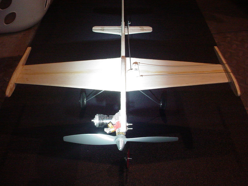

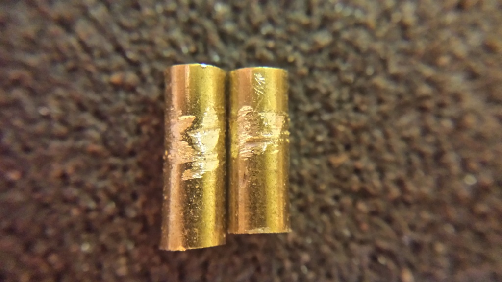

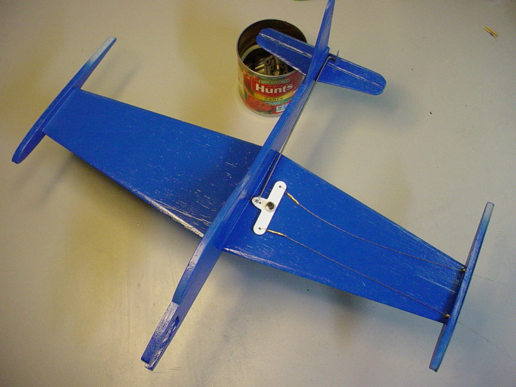

How to configure the lead-outs on this T33 had been bugging me.. so I just decided to stop procrastinating and do it.
These 1/8" brass-tube "guides" are embedded-into the faux inboard wingtip-tank.
The bell-crank is a homemade unit; similar to the one used on my Rare Bear.. only a little larger. The lead-out cables were salvaged from some old/retired .018" stranded line-sets that I've had hanging around for decades.
This airplane is going to be a handful to fly.. if I can even get it in the air. The control-throws will be minimal to begin with.

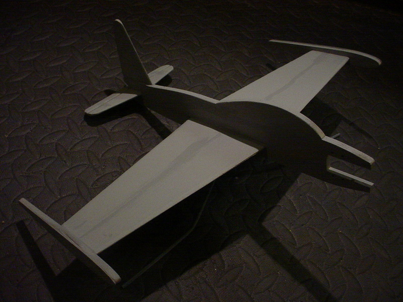

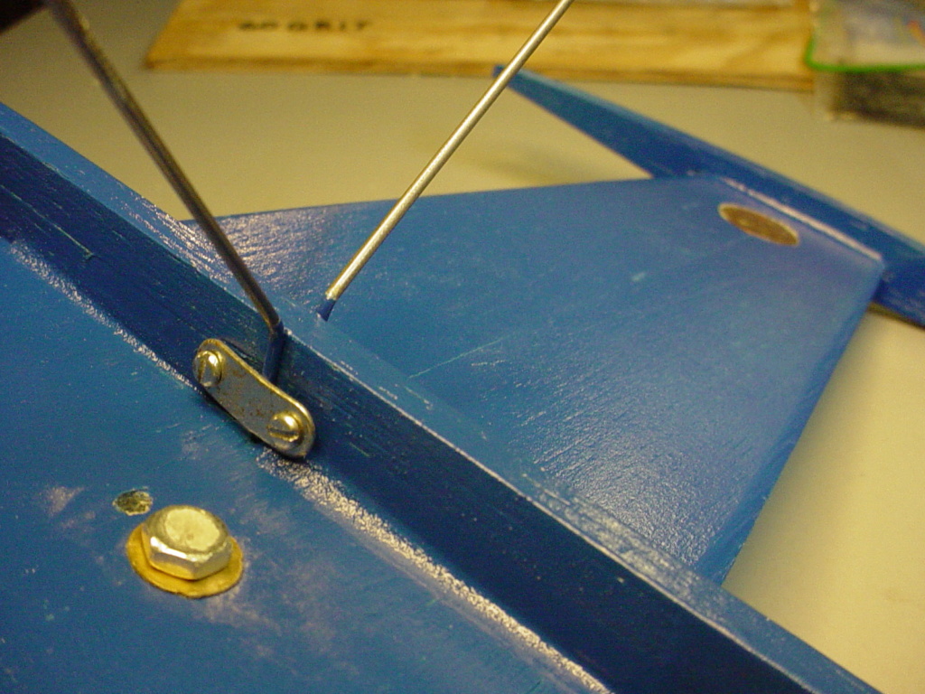

I had initially installed a "metal" elevator-horn to this model.. with its link on the "upper-side" of the elevator. This proved to be a BAD arrangement. The control-throws couldn't be equalized. I had to "cut" the metal horn out.. and install a small Dubro horn assy. #107 with its link on the "underside" of the elevator. This helped to equalize the control-throws.
This was a MAJOR PIA.... but I'm really glad that I did it..

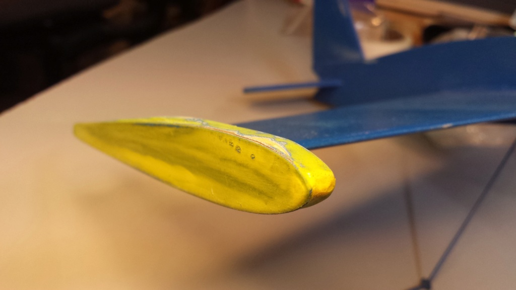

Next..... I chose to apply the exact-same method of adding outboard wingtip-weight to this model as I did for my P-38..
I cored the outboard wingtip with a 3/4" dia. (.750") hole-saw.. to install x2 "pennies".. which weigh 4gr./ or .15oz.
I glued the two pennies into my sheet-wing with thin-CA glue.. and applied some spackling-compound.
Tomorrow.... (July 4th..) I hope to prime/re-paint the tip-weight areas.. but the weather might not permit that.
