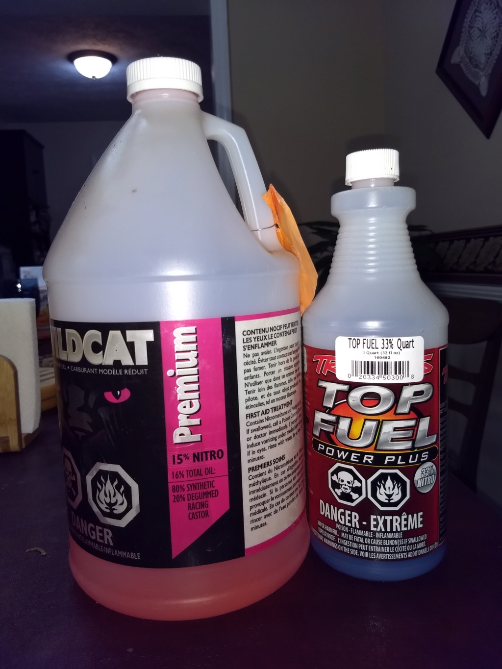

Post  944_Jim Mon Sep 24, 2018 12:24 am
The two fuels most readily available to me are:
Wildcat Premium with 15% Nitro, 16% Oil (80% Synth/20% Castor)
Traxxas Top Fuel Power Plus 33% Nitro
The problem with the Traxxas fuel is that oil make-up IS NOT marked in the bottle, nor their website. I had to glean the content ASSUMING they blend for their buggies/truggies/cars as called out in their "owners' manuals.
With that in mind, my mix is as follows:
3.5 oz Wildcat
4.0 oz Traxxas
0.5 oz best grade Castor Oil from local Apothecary
This yields approximately 8 oz at 23% Nitro, 19% Oil. My notes indicate this gives 8% Castor Oil, which ISTR being of the total fluid volume.
My glow plugs stay pretty clean. The oil splattering out of the exhaust is pretty clean, and wipes off the models with little effort. When engives are bench run, they don't get too hot when measured on the head with a laser thermometer.
