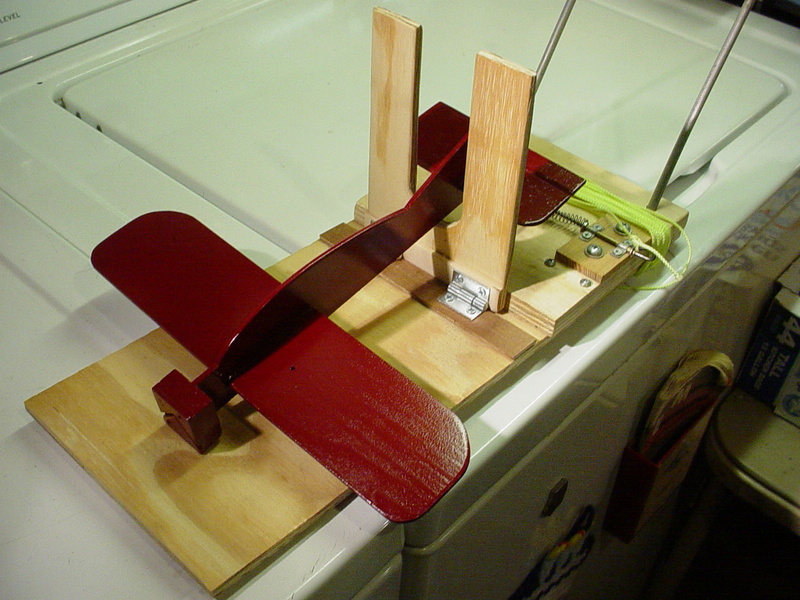

"Is that the cat that chewed your new stooge"?.. (I'm goofing..) It had been on my mind that I needed to redesign/modify my launch-stooge. I'd been wanting to make the hinged "U-shape" that I've seen some of you guys use.

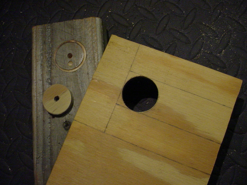

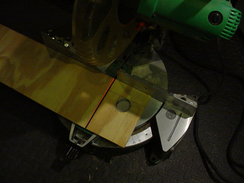

I started with a piece of 1/4" plywood. Making the "U" was the easy part..
I had to buy a pair of small hinges..
(that irked me.. because I'm frugal..) I utilized a previously-built stooge for its pin-release.. and used the remaining piece of 1/4" plywood as a base.
Here's the finished-product. The two aluminum "spikes" come from roof-gutters. They fit into holes in the rear-plate that are drilled-through at a 45 degree angle and anchor the stooge when used on a grass circle.
There was a bit of trial and error shimming involved.. to get the "gate" to drop smoothly.
The stooge should now work with just about any conventional 1/2A C/L airplane that has landing gear.
even the fork-tailed P-38..

Hmmmm.... Looking at how the red plane fits in there, and how close the top of the stooge looks like hitting the trailing edge of the wing, I get an idea. Have a piece of piano wire that goes through both hinges that can be pulled out from the side to separate the hinges. Have one large U-shaped plate for larger planes, and a second smaller U-shaped plate for 1/2A planes.

batjac wrote:Hmmmm.... Looking at how the red plane fits in there, and how close the top of the stooge looks like hitting the trailing edge of the wing.
Mark
If the model "stood still".. then yes; the gate would contact the wing's leading-edge. The model will move forward as soon as the gate drops.. and the wing's trailing-edge will clear it with inches to spare.
The little red airplane is an extreme example. It may be too small for a stooge-launch. I have a "rail" which attaches to the base-plate of the stooge and acts as a "curbing" for the inboard main-wheel on the model to ride-against. I needed it with the F8F-2 Bearcat to keep the nose from "skidding-inward" on smooth pavement when checking the controls from the handle.
