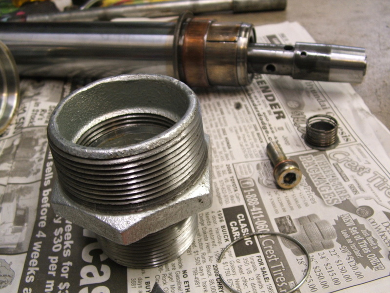

Also improvised a sliding hammer seal setter with a galv. cast iron 1-1/2"x2 pipe nipple and 2"x1-1/2" pipe reducer bushing. Used the pipe nipple to set the front shock fork seal, other end of the reducer to set the dust cover.
Defeating spring pressure 2014-012
Defeating spring pressure 2014-011
Defeating spring pressure 2014-010
(Anyway, sorry to deviate off-topic on an off-topic discussion.) lol!
