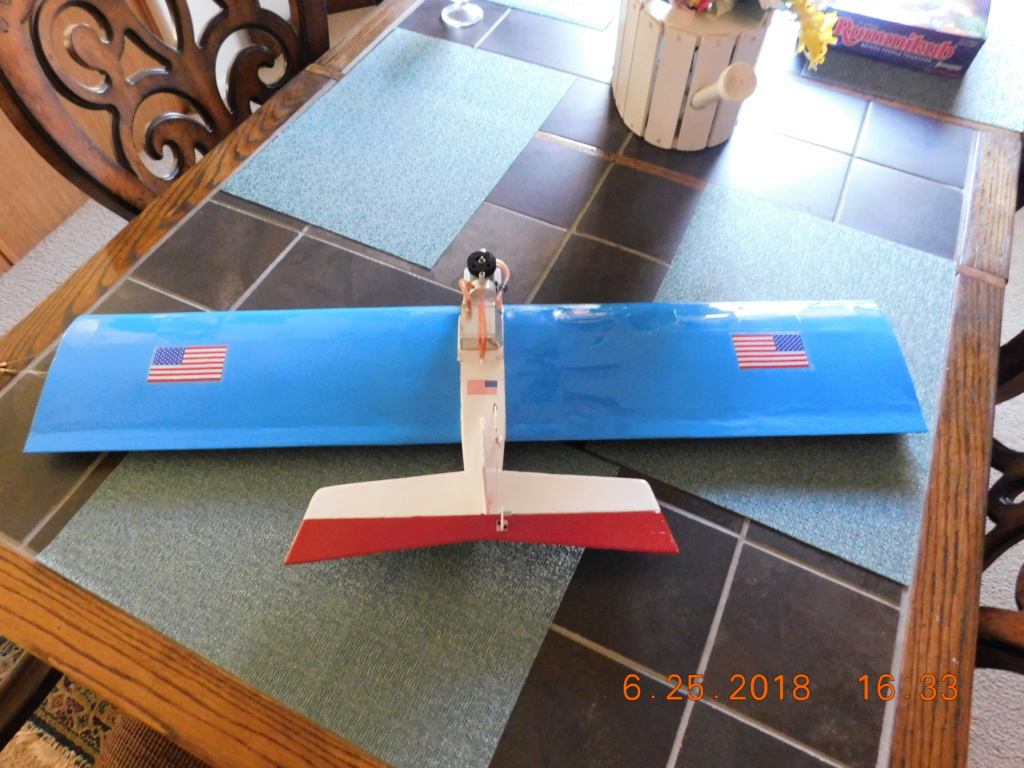

Well I saw a picture a while back of a Quicker the .35 size.  So I started scratch building one, but a .15 size. I pickup a AP .15 and with the muffler on the rear, I thought it would be a good choice for it.
My new plane Dscn0311My new plane Dscn0314My new plane Dscn0316

Post  1/2A Nut Mon Jun 25, 2018 1:38 am
Looks great good job on the build!! Thumbs Up
It should be fast. The muffler will need it's exhaust tip to the side so oil doesn't
collect in the muffler. Down being the best solution for complete oil drain.

Post  oldguy Mon Jun 25, 2018 6:32 pm
Well this is it.
My new plane Dscn0317
My new plane Dscn0319
My new plane Dscn0318

Post  oldguy Mon Jun 25, 2018 6:35 pm
1/2A Nut wrote:Looks great good job on the build!!  Thumbs Up
Thanks for the comment.
The plane will be upside down half the time or more so I really don't see the exhaust pointing up being a problem. Only flying it will be the true test.
I have one question, where do you think I should start with the CG?

Post  Ken Cook Tue Jun 26, 2018 4:28 am
One thing that grabbed my attention is the tank, at least from the pictures it appears as if the engine is sitting on the beams and the tank is shimmed up considerably higher. This could really make the engine go lean when inverted vs upright. Unless you absolutely know where the height of the pickup tube is soldered within the tank I would just be aware to that situation and set the engine off slightly rich. Once you do a outside maneuver, it will become quickly evident if the tank height is set correct. Balance the plane where the front leadout exits the tip. This will almost always place your plane in a nose heavy condition and work from there removing it to make it more maneuverable. When the power cuts, examine the plane's glide path on it's return to the ground. If it's too nose heavy, remove the muffler because it robs about 1500 rpm's. It retains a lot of heat as well.

Post  oldguy Tue Jun 26, 2018 1:52 pm
Ken Cook wrote:         One thing that grabbed my attention is the tank, at least from the pictures it appears as if the engine is sitting on the beams and the tank is shimmed up considerably higher. This could really make the engine go lean when inverted vs upright. Unless you absolutely know where the height of the pickup tube is soldered within the tank I would just be aware to that situation and set the engine off slightly rich. Once you do a outside maneuver, it will become quickly evident if the tank height is set correct. Balance the plane where the front leadout exits the tip. This will almost always place your plane in a nose heavy condition and work from there removing it to make it more maneuverable. When the power cuts, examine the plane's glide path on it's return to the ground.  If it's too nose heavy, remove the muffler because it robs about 1500 rpm's. It retains a lot of heat as well.
Yes Ken I shimmed the tank up some to align with spray bar, I didn't build the tank so I assumed the pickup tube runs straight back along the groove in the outside of the tank.  And yes with the first flight I will see if the height of the tank is going to work where it's at.   And I just checked the balance point and it balances just a tad aft of the front l/o.  So i'm assuming it will need some tail weight eventually.  so you have ran one of these ap .15?  Would you suggest I install just some sort of straight tube off the exhaust port in place of the muffler?
