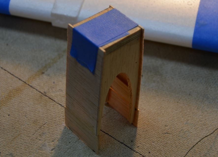

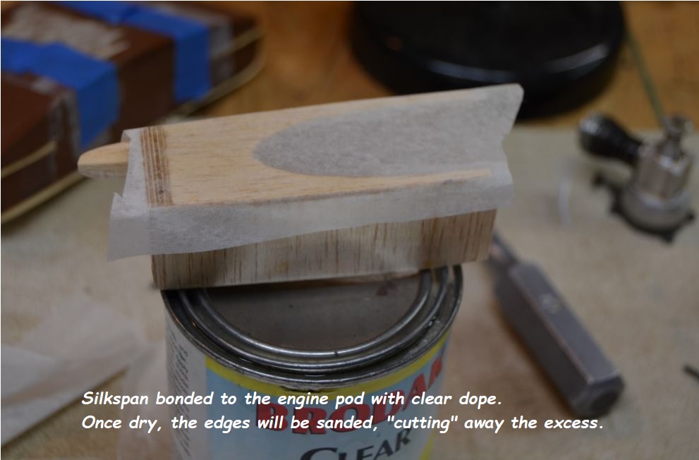

Working on the balsa parts this morning.  Using Brodak clear dope to bond some light weight silkspan to the fins, elevator and pod.  This is great 'flashback work' for me as the only difference from 1969 is that I'm using Brodak dope instead of Aerogloss.  Fills the shop with that great 'model airplane smell' that used to get me evicted to the front porch by Mom...and later on, a couple wives!

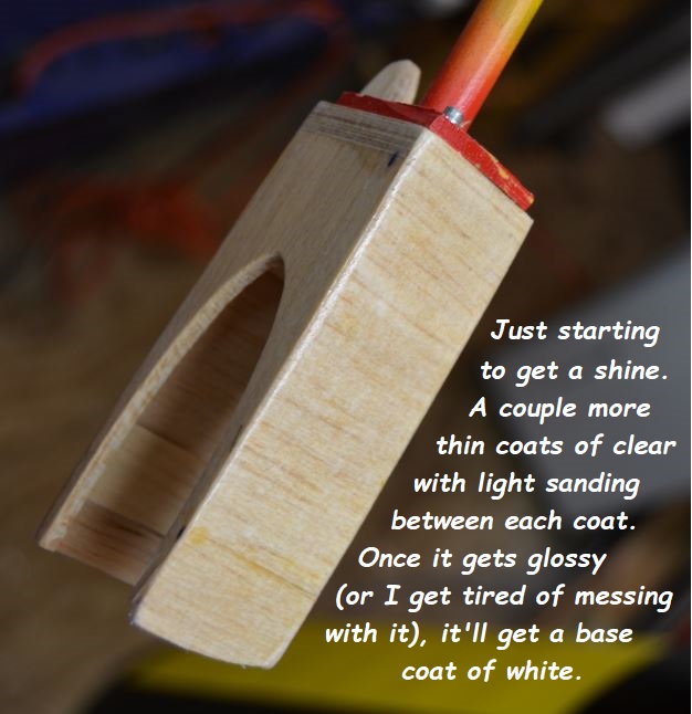

And so, the project has entered "The Tedious Zone".  The engine pod and tail feathers have been covered with light silkspan, bonded to the balsa with thinned clear dope, with successive coats and light sanding, hopefully bringing out some gloss.
Luckily, I was actually in the mood for this stuff today, alternating new clear coats with pushing a lawn mower around the yard.
Once I'm happy with the shine, I'll paint the parts white for a base, and figure some red trim to finish up.
