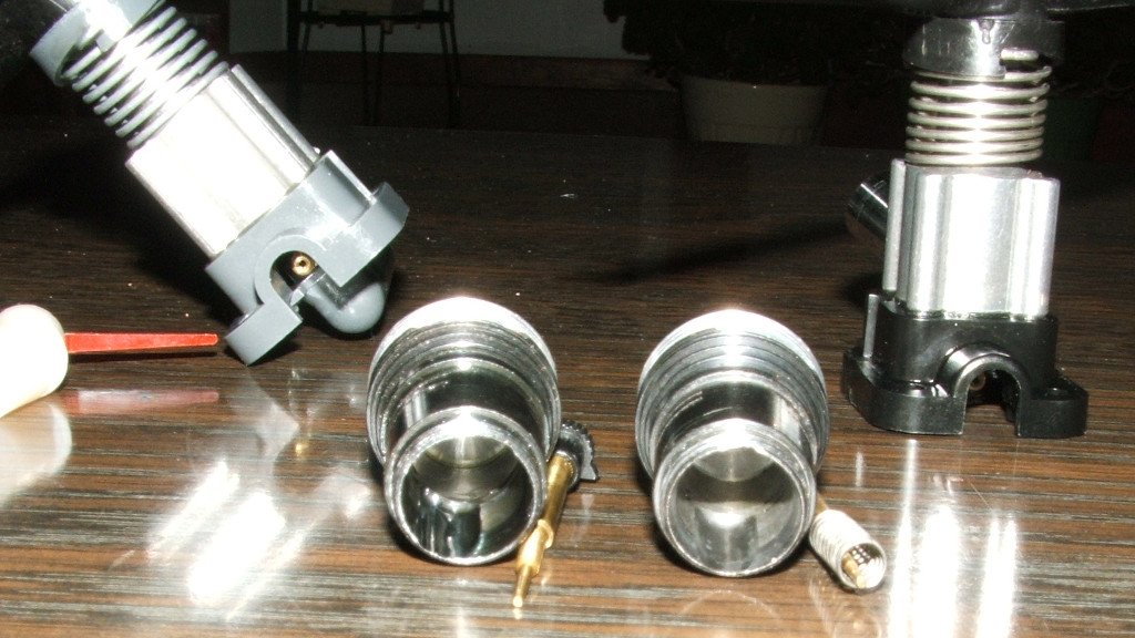

Post  Jason_WI Mon Aug 20, 2018 11:24 pm
I have one of those cylinders. I built it into a TD RC05. Not sure where I got it from or what it’s from. Too many engines to remember all the details. Need help with an unusual .051 cylinder F3510a10
Need help with an unusual .051 cylinder 95601e10
