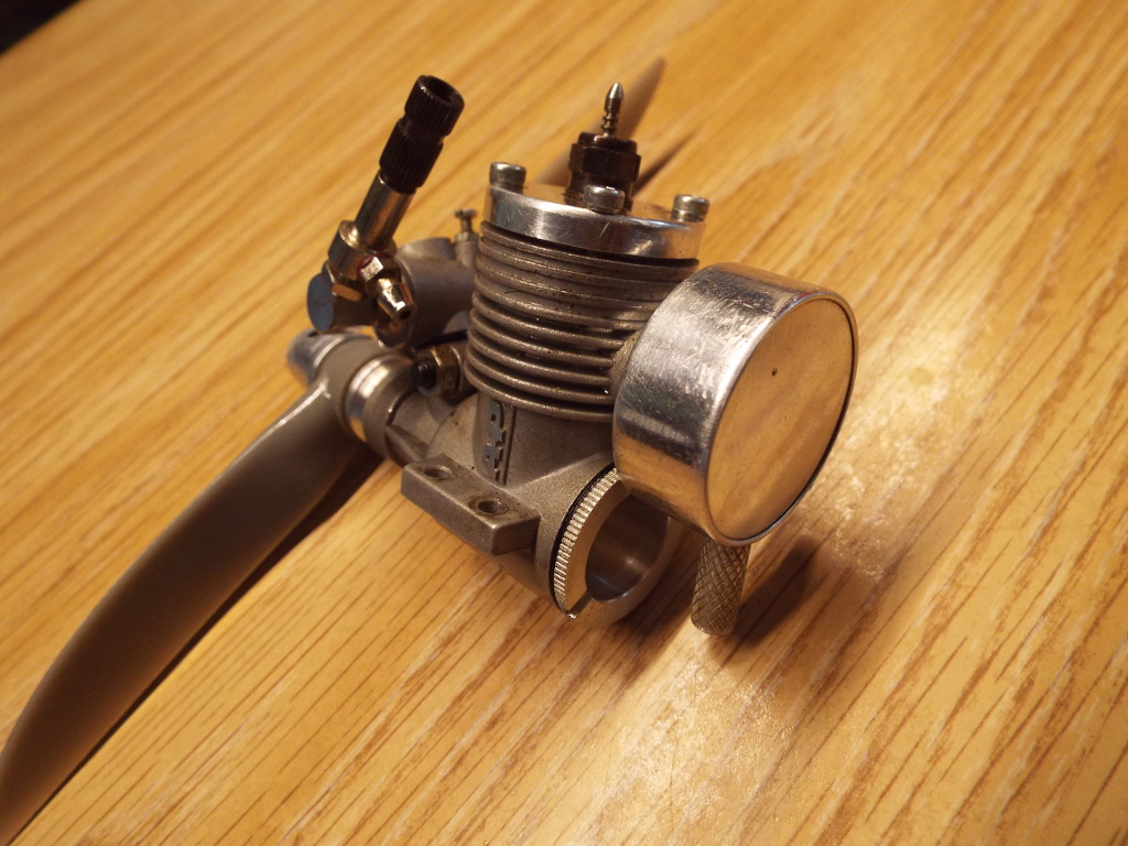

Sanye AP 09 RC
It arrived today (Aug 22, 2018). I bought this engine on E-Bay (Aug 19, 2018). It came from Las Vegas, NV, $9.99 + 7.19 shipping for total of $17.18 USD ($14.18 EUR). Appears it was run on Castor only fuel, engine was frozen solid. After removing head, back, muffler, NVA, carb control arm, I shot modern (probably) 5-30W motor oil from my squirt can in all three holes, coating available mating surfaces. Let it soak for about 15 minutes.
The bearing, from what I could see, balls were still shiny, appears that the extra dry weather in Las Vegas helped to keep water moisture down. Congealed oil was your typical very dark, shiny thick honey gum.
Then installing a prop, slowly, carefully and methodically, worked the prop until crankshaft broke loose, continually moving back and forth gradually and increasingly until was totally free. After several rotations, was free enough I kept on rotating until it was very free moving. Then worked carb barrel until free. It's got very good compression, appears to be a used but not abused engine.
Later I'll test run it, but doesn't appear need to fully disassemble. It may have been a control line engine. Exterior cleaned up really nice just simply wiping down with an oil soaked paper napkin.
I'd been looking at these Sanye AP 09's for a while, seeing them advertised in various modeling sales venues, but when I wanted to buy, they were already discontinued and no longer in stock. The nifty angled needle and light weight muffler I though would work good on a profile CL airplane of the right wing area, hence the interest.
I'll know more when I bench test, but so far I'm stoked.

Re: Sanye AP 09 RC
So you are the one...I came close to bidding, but would up doing something just before the auction closed. You basically stole it!
I've got a CL variant (venturi, not carb). From what I've read, the muffler to head gasket is the same as a Cox .049 head gasket. You stack the gaskets to get your desired muffler angle.
One of the forums mentioned drilling the muffler outlet a little bigger to get some more oomph from it.
I hope you enjoy it. I keep watching for another CL version to make a bigger twin with.

Re: Sanye AP 09 RC
1/2A,
5x3 prop? Isn't that what the Cox rubber duckie is?
I figured this engine should be able to swing a bigger prop with authority. It is almost twice a Cox in size.
Any chance you have access to a Norvel BigMig .074?
I'd like to know how the AP stacks up against the smaller Norvel since I have a pair on the Mossie.
If the AP can't keep up with the Norvel, then I think I'll skip searching for a second one with the venturi.
Thanks for your input.

Re: Sanye AP 09 RC
1/2A Nut, you had that Sanye turning and burning.
I've got a mild APC 7x3 prop on it for now, just for test running. When I get a chance to run it, will post results.
Jim, having the CL version, you've got an unusual one. The only ones I've seen for sale thus far are the RC throttled ones.
I used a 7x3 on an Enya .09-III TV, it flew a half-A plane very .049 like, but really opened up with a 7x6 wood. Since the Sanye has a higher RPM curve, I imagine that once unloaded, it will probably pull a plane with a 7x3 to 7x4, may be a 7x5 like it had a .15 cross scavenge engine.
The limiting factor here may be the very restrictive stock muffler, it has a very small expansion chamber like the old Tatone Calumets (when internally molded baffles were removed). 1/2A Nut's tuned pipe is the ultimate, but I imagine that a larger chamber muffler like a small can muffler would do it good. Caveat would be making a suitable header pipe with the right thread. However, its stock muffler is attractive in that it is compact and light weight.

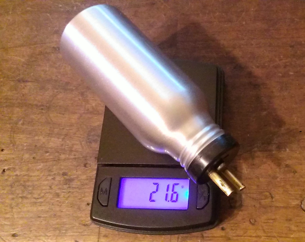

Re: Sanye AP 09 RC
You can use a Saito .72 muffler on it the threads fit. Look at the still pic
in the vid before hitting play as I have it covered up when running to
keep the goo on the towel.
Published on Dec 9, 2015
AP .09 Hornet
MA 5.5x4.5 19,300 / .92lbs /14.72oz thrust / 82mph /.20hp / 149w
est. unloaded 21.3k / 91mph

Re: Sanye AP 09 RC
944_Jim wrote:You basically stole it!
Jim, you're right considering I got it for $10 before shipping, but then they were a low cost $30 engine when new 10 years ago. I find it difficult to believe that some think now they can get $77 to $90 for their NOS engine. Did notice that no one on E-Bay wants to pay those prices, as they remain unsold at auction close.
Gasket is smaller, would have to check, but I think a .020 or .010 gasket would be a better fit. Exhaust port is definitely smaller than .049 gasket diameter.944_Jim wrote:From what I've read, the muffler to head gasket is the same as a Cox .049 head gasket. You stack the gaskets to get your desired muffler angle.
Muffler exit tube is thin wall, may be 1/32" to 1/20" thick. I suppose one could drill out the hole, but then would lose the pipe that gets the glop away from the engine, although I guess they could drill and tap a hole and cut threads on a larger pipe. Might increase noise to objectionable on some flying fields.944_Jim wrote:One of the forums mentioned drilling the muffler outlet a little bigger to get some more oomph from it.
1/2A Nut wrote:You can use a Saito .72 muffler on it the threads fit. Look at the still pic in the vid before hitting play as I have it covered up when running to keep the goo on the towel. Published on Dec 9, 2015; AP .09 Hornet; MA 5.5x4.5 19,300 / .92lbs /14.72oz thrust / 82mph /.20hp / 149w; est. unloaded 21.3k / 91mph
Thanks for simulating unloaded in flight RPM and lead on a less restrictive muffler, Brad. I looked at Saito threaded header pipe adapter and mufflers, going current higher E-Bay prices negate that option for now.

Re: Sanye AP 09 RC
The Saito .72 muffler might be but that all thread coupler is not and can be
bought separately. You can use a standard exhaust deflector attached to the
all thread and bingo bango extra power and nice throaty muffler sound with
goo deflection is yours on the cheap.
Also the much cheaper ASP parts fit example from the ASP .30 4 stroke engine shown.

Re: Sanye AP 09 RC
Thanks, Brad for letting me know of these good solutions.

It is amazing what a little clean up does to an engine. I cleaned / polished the bare aluminum parts, the coned prop nut, muffler and head with Mother's Mag Aluminum Polish, brushed the dust and loose bits off the crankcase. Found there was a burr on the carb mount shaft, filed off with a fine file, now it sits where it should compressing the O-ring. It will be ready to run, once I find where I put my engine stand and run up tank.

Very nice
looks ready for some fun now, note your NV is missing the spring steel clip.
**See pic for reference, note I bought a batch of thick mil zip lock bags for my engines.
I was tired of seeing scratches from being bundled in the same bin.
Also bought a batch of small aluminum bottles labeled to hold 50cc, actually bit more including
the neck just under 2oz. Going to make fuel tanks out of them, in theory should help keep the
fuel cooler prior to entering the engine. Good for thirsty engines from .07's to .10's
Also note I changed the head bolts out to hardened heat treated black oxid ones.
21.6g ready to use.

Good eyes, Brad, I hadn't noticed the needle ratchet was missing. A closer look, O-Ring makes needle movement stiff so it doesn't move much, under vibration would be a different story. I may be able to take some fuel line, use a nylon wire tie or wrap a couple loops of soft wire with ends twisted over the chromed needle holder portion to hold needle in place.
Never seen those, they are unique aluminum bottles, a neat way to fuel these engines in a compact manner.
