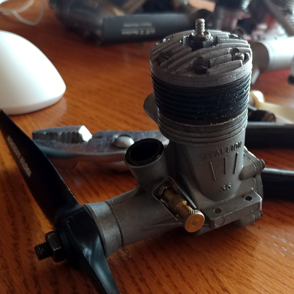

Just need to locate my Utra Gray RTV sealant to make a gasket for the backplate. The sewing machine oil has now loosened up the crankshaft, flips freely. This engine has gobs of compression, hardly run. Essentially, I have a brand new engine.
Using the edge of a flat blade screw driver, I trimmed off the flashings from backplate surface edges. For some reason it had more than I have seen on other engines. Compared with the other Stallions I have, this one has a darker gray bead blast appearance, like that of the Testors Series 21 Black Heads. Yet where I scraped the flashings off and where there is slight wear from the nylon crankpin rivet, it is bright aluminum. Perhaps it was from the way it was chemically cleaned by the factory?
I am glad I purchased this engine for a very reasonable price even with shipping.

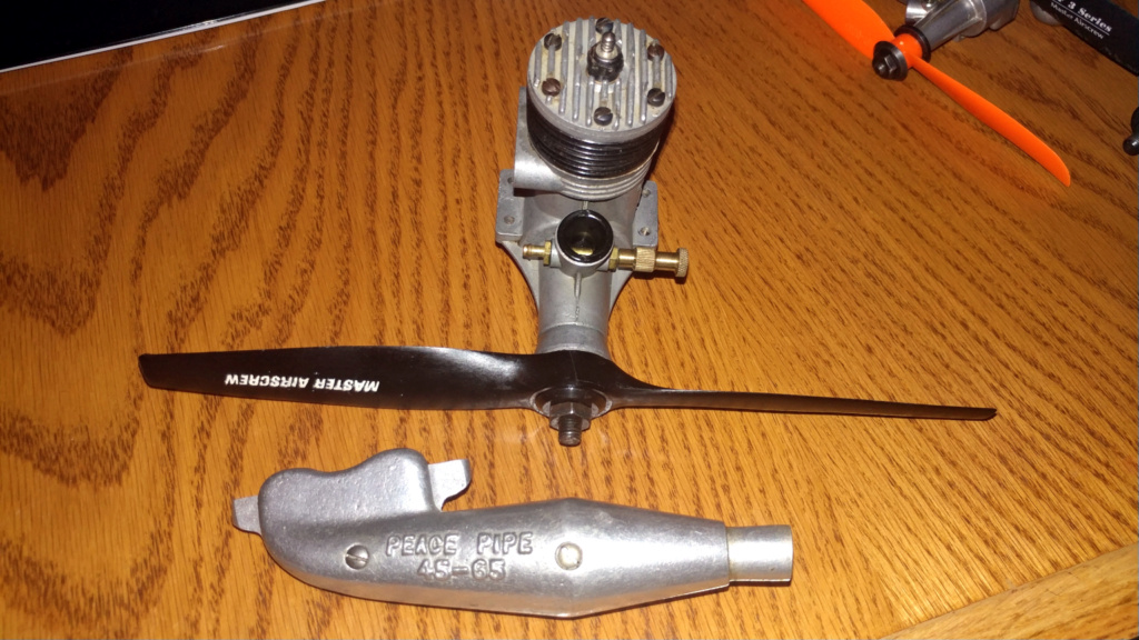

Now that the engine has had some time to allow the light machine oil to soften the congealed Castor in the crank plain bearing area, after flipping a couple dozen times accumulated over time, the engine now has a very strong compression pop and the crank in the plain bearing area has loosened up. It now freely turns over like a well oiled new engine.
I have several Tatone .45-.65 Peace Pipe mufflers, both long and short. Here, I have a short one. Although the mount area is wider, it actually appears right sized for the Stallion, generous expansion area. (In other thread, I mounted their .19-.40 Peace Pipe to an Enya .19-VI TV. It is a little smallish chamber wise to fit the .35.)
This larger muffler will provide decent muffling while helping the engine not to overheat while muffled. The annular exit appears to be 3/8" diameter, but it has an orifice ring inside with 1/4" diameter, which can be drilled out to 3/8". The 1/4" is probably OK for the Stallion.
Once I find a suitable width adjustable stainless steel hose clamp, will cut it into 2 pieces, drill, bend, mount, and cinch reasonably tight (not too tight to prevent distorting the aluminum crankcase), to mount the muffler.
Size comparison of the Tatone muffler with Sportster .20 and .45 mufflers. These Schneurle port engines have approximately the power of the older cross scavenge plain bearing cross scavenge sport engines of .35 and .60 size respectively. As one can see, the Tatone muffler, roughly same size as with the .20 Sportster is best suited for the .35 Stallion as the upper end. I would not use this muffler to silence an older .60, good way to overheat and ruin it. (Which, I gather a good number of folk did, giving the mufflers a poor rap.)
Here's another comparison of the Tatone .45-.65 Peace Pipe with the muffler of an Enya .35-III TV. The chamber volumes are proportionately similar in size.
The .29-.40 Peace Pipe would be a poor choice for a .35, here I have it mounted on an Enya .19-VI TV, with the smaller .09-.19 Peace Pipe next to it. The smaller muffler is a better match for a .09-.10 cross scavenge engine.

Ken, was your Dad using the smaller .19-.40 Peace Pipe, or the larger .45-.65 one? So far, my only flying experience has been with the .09-.19 on an Enya .09-III TV. The Engine flew well with it on a 40" old foamie, a Hobby Shack Cessna 140 that was originally for a tanked .049 reedie. It ran well with the muffler. Chamber wise, it was about the same size as the OEM muffler.
(The Enya turned the plane into a really nice 3 channel sport plane. It moved out with authority on a wood T/F 7x6 prop. On an APC 7x3 plastic, it flew very .049 reedie like. I got the impression that some who didn't understand the torque characteristics of the Enya, that it developed its peak power at lower RPM probably were not happy with it when they tried to prop it like a Schneurle or an HB. I need to put that plane back into service, it was a blast to fly on Enya power.)
I plan to use some RTV sealant on the muffler, its seams and interface to the engine. This will act as sort of an adhesive plus seal against baked on Castor on the exterior.

There is some madness to my wanting to test out the Stallion on the Tatone .45-.65 Peace Pipe muffler. I have also an R/C version that I acquired, 3rd one in the photo, where the Peace Pipe would provide some back pressure for idle, but cut the bark in flight. I still need to clean it up, carburetor is frozen in congealed Castor oil. I have a 66" 1941 Vanguard 66 F/F repro kit by Al Lidgard F/F Services out of Fresno. The .35 Stallion R/C would be a good engine for it, because of its heavier weight with muffler, mild horsepower (around 0.42 BHP) and it's ability to swing larger props than what someone on RC Groups recommended, only a .15 engine. (If it had a narrower cross section like a PAA F/F, then, perhaps it would be worth trying the smaller engine.)
https://outerzone.co.uk/plan_details.asp?ID=4963
Living at higher elevation, I lose some power due to the thinner air, so going up on engine size makes up for power loss at elevation. Plus, I believe in using props to scale down power if necessary. The Stallion should be able to turn a 11x3 prop with ease. The Vanguard, although competitive for its time, wasn't the most aerodynamically sleek aircraft. A 10 or 11 inch prop puts more air past the fuselage cross section than an 8" propeller would.
1) Stallion I've been working on; 2) Stallion I restored; 3) Stallion R/C to be worked on.
Over the past week, I have been randomly flipping the prop on the first Stallion in the photo. It has loosened up quite a bit, has like new compression. My flipping it here and there is like having a spinner.
For us engine buffs, hand holding a model engine and flipping its prop is basically our spinner pacifier.

Just finished installing the missing ratchet spring for the needle valve salvaged from a Testor McCoy .35 Red Head parts engine. This completes my 2nd K&B .35 Stallion engine, with like new compression, should make a good C/L engine.
The world of CL is full of compromises. Appreciate all the inputs from Ken and others who were experienced users with these engine.
This engine may have been an unloved child (thinking of Diana Ross and The Supremes' song Love Child, 1968
in some modelers' eyes because in the "circle"
was unable to do the cherished (reminds me of Cherish by The Association, 1966)
4 -2 - 4 break, a legendary preference amongst the stunt crowd,
along with its wider beam width making it tougher to be a replacement engine for existing aircraft.
But, interestingly enough, there were those who were able to make do with its so called misgivings, and put the engine to useful work, with longevity that the Testors Red Heads only hoped for.
