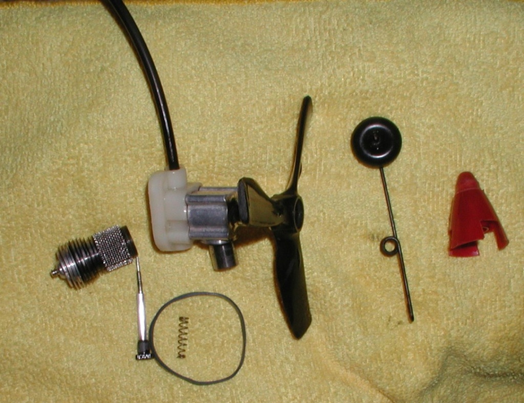

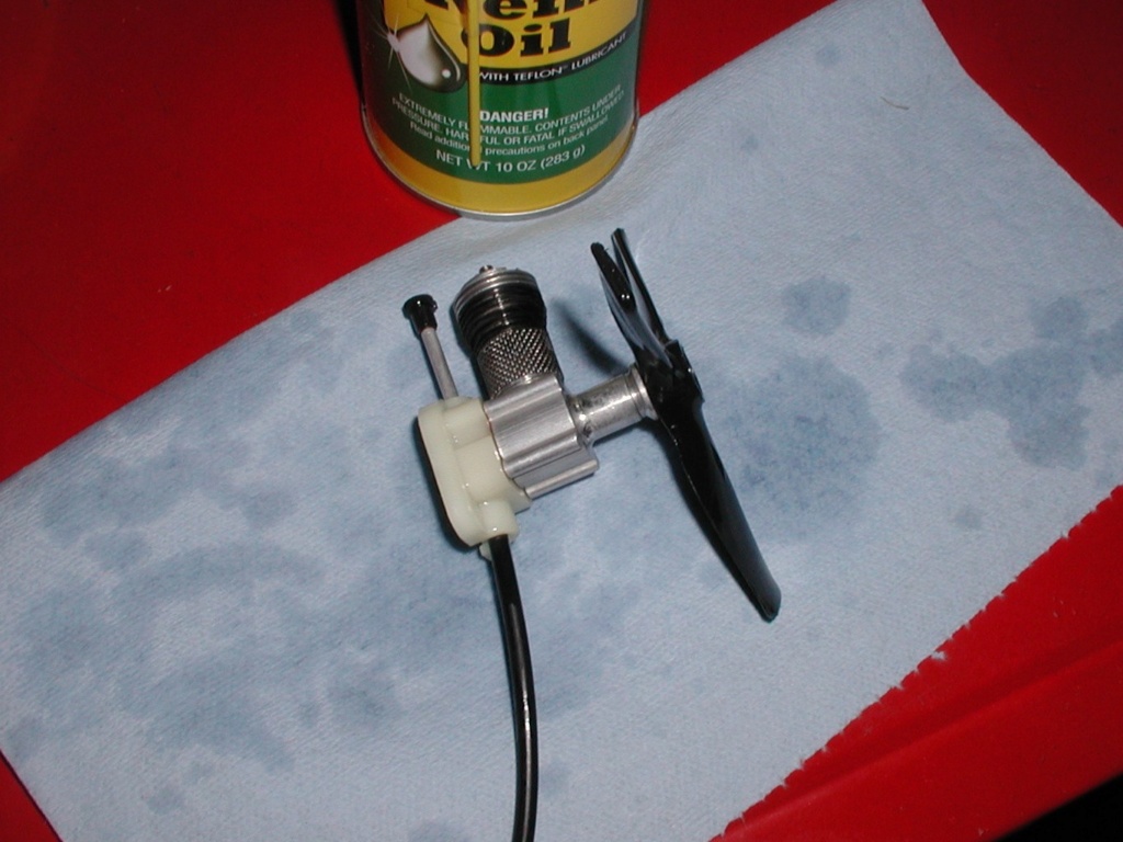

I have done this before with great results.
Engine - Simple Green immersion with lot's of prop turning, water rinse, RemOil spray finish in every opening, compressed air blow out, lot's of prop action.
Body, SG spray, light paper towel, hose off, dry, compressed air down both vents cleans fuel tank of water/fuel residue.

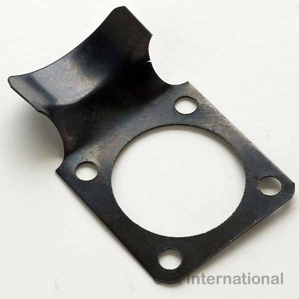

Thanks, Jason_WI for the clarification on the screened cylinders. Looking how the plastic F-15 cockpit area partially covers the cylinder, I'm thinking that for another cylinder to work would require CI - Cox .049 Exhaust Deflector Shield
WV Redneck F-15/engine clean-up Cox20010
I'm a little surprised that Cox did not mount the engine cylinder sideways, which would have allowed for a fuller cockpit presentation (water under the bridge). What?

Simple Green comes two ways, standard household and concentrate. I used the concentrate here and cut it by about 1/3rd. Don't heat it as it will blacken the case especially if left in the fluid too long.
Yes, full immersion while operating the propeller. You will get hydraulic lock if the head is attached, simple just back off and expel the concentrate then prop again. This action cleans the reed without removing it and eliminates the possibility of damage. I usually remove the glow head avoiding lock, but no way on this screened engine to get the second Cox wrench in the exhaust ports.
The key is compressed air blowout and drying followed by RemOil which over time evaporates and is reputed to leave a "Teflon" film. I have used it for years on my engines and never found fault with it. Early on, I used WD-40 and learned a painful lesson. Sad

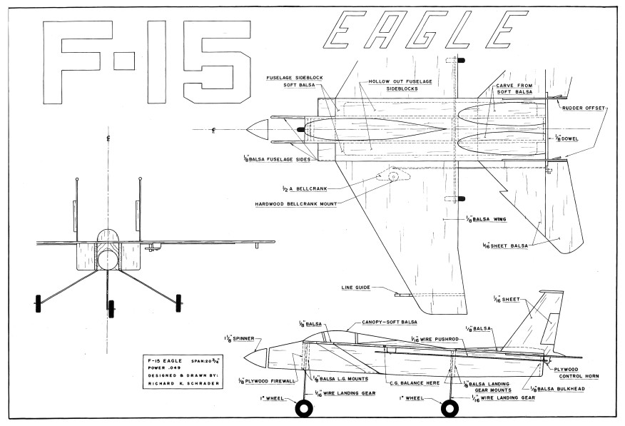

Hip Pocket Aeronautics (membership required - free) has a 20.75" wingspan HPA Half-A F-15 CL Plan that would make a better flier if kept light.
WV Redneck F-15/engine clean-up Hippoc10

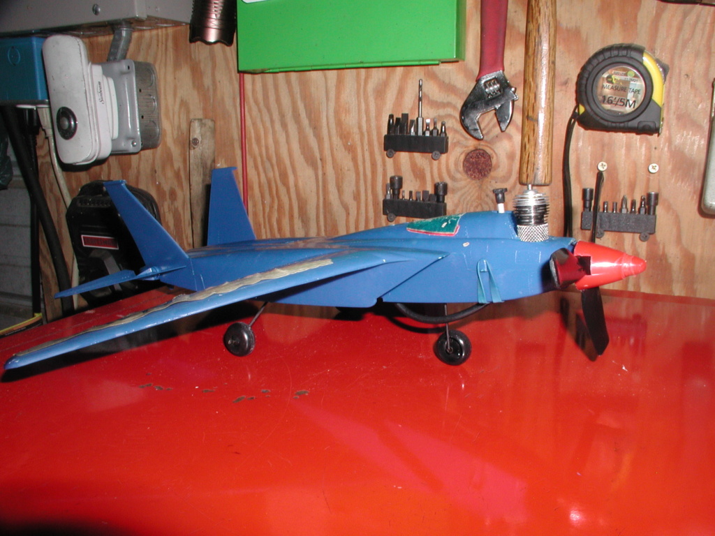

Checking the F-15 this morning after it had fully dried I was gratified to see that it cleaned up so well. Just a spritz or two of Simple Green got in all the hard to get at places followed by a hose out with water sure made cleaning it easy. It was a dirty greasy mess.
WV Redneck F-15/engine clean-up Cox_f115
WV Redneck F-15/engine clean-up Cox_f-11
WV Redneck F-15/engine clean-up Cox_f-10
I'm going to try the SG treatment on the Corsairs balky engine today to see if it frees up the reed without disassembly, then try to get it started. Might substitute a clean hot water rinse instead of cold.
