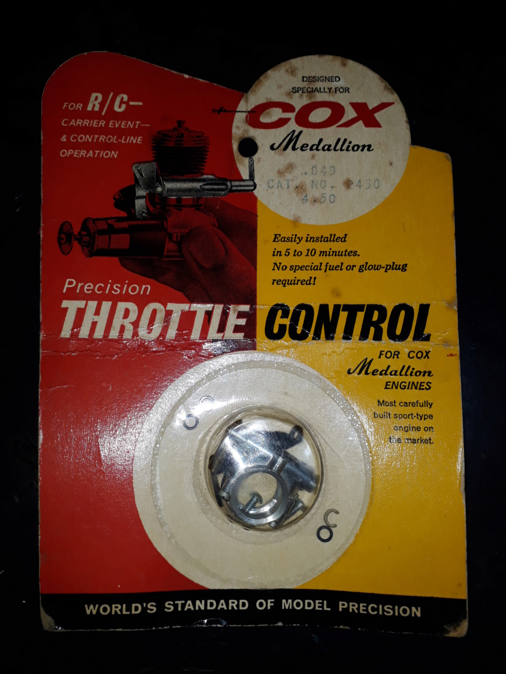

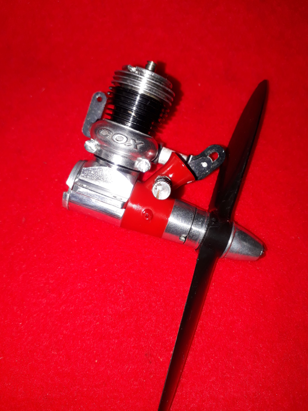

Post  MauricioB Fri Nov 09, 2018 12:02 am
Hello friends, I want to share with you my new experience, it is the accessory for Cox Medallion .049 "bar type". I have seen that the engine was manufactured for the first time in 1968 with this device.
Well, here I share my experience with this engine, without doubt is another wonder of Cox, in addition to the aesthetically beautiful, I greatly surprised the ability to operate at only 3500/3600 rpm with a very low sound! ideal not to disturb the neighbors for workshop nights! hahaha!
If you are so kind, I would like you to share your experiences with me and learn more about this other great piece of Cox!

Very Happy Thanks guys for your comments. It is important to note that this accessory is not possible to be placed in any cylinder of Cox Medallion, it can only be placed in thin-walled cylinders, I clarify this because I thought it was something very simple, however I had to adapt the silencer, beyond that I am using a cylinder of two transfer tubes and thin walls with skirt. Huh...

Agree, Mauricio, that's a nice demonstration of the earlier Cox Medallion throttle assembly. I hadn't realized you could get a really low reliable idle. Plus, response seems more linear over the exhaust throttle ring.
I've used the more modern muffled and unmuffled throttle rings on the reedies, R/C Bee (muffled) and Golden Bee (unmuffled). They worked well and were reasonably inexpensive, but never got that tick over idle.
I gather that though a better product, that it was more expensive to manufacture and back then there was less demand for throttle. Cox needed to be competitively priced with the other RC half-A engines out there. Would understand why the assembly would not fit the later thicker walled cylinders, item was discontinued before them.
You've illustrated a nice piece of past history we see little of now.
