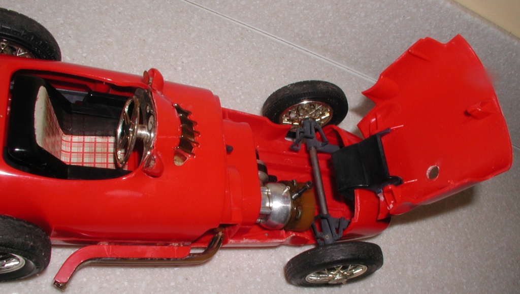

Eight days on the road, poorly packaged, one end hanging open but it's here.
Body is beautiful. Scratch-less, and I can't find a flaw. Insides the same.
But there are nits to pick.
Mirrors poorly cemented on, missing the windshield, worn and dirty tires, top of the seat faded, and one wheel knock-off has lost it's chrome but nothing is broken. It will help me put old #2 back together. Better donors from #2 will substitute including a near perfect windshield.
There is no question that I will enjoy the first one more, already have. It will be active while this new one will just sit.
These must have been supplied with stick on # decals. Wonder if they are still available?

This is curious and poses a lot of questions.
The body looks brand new inside and out, no fuel residue at all and the engine appears to have never been ran. But the rear tires are worn (fronts look new) if however slight and the fading of the seat and nothing else is a head scratcher.
Re-body? Maybe, but what about that engine. Kid pushing it around wearing the rear tires? It will still get a clean-up especially the tires. I almost hate to, tire treads look like they have tiny rocks embedded in them. Almost scale from Le Mans.
Think I will ask the seller.
I dunno...........

My bet is it was pieced together using good parts from several models. So the body may very well be unused, but chassis parts could have been at one time.
You already know how easy it is to make an engine appear new.
