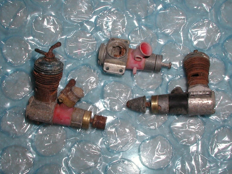

Was I the only one here to bid and win on just one of three ebay auctions featuring Cox engines that were involved in a fire? There were two other auctions of .010 and .020 engines that suffered the same fate.
I "won" these for the princely sum of $11.61.
Just curious..Cox burned engines Cox_bu10
Just curious as to how other "winners" are going to clean them up or just leave them as is.
I don't know how to deal with the darned things. A/F crock pot would lighten the anodized parts and leach the color out of the plastic parts. Perhaps a few hours in ATF, or a hot water scrub with a dish detergent followed by a hot water rinse and a light oil, then a light heat gun to loosen and remove the parts?
I'm pretty sure that I can get all three running again if the pistons are not rusted to the cylinders. I have replacements.

I would clean them and run them. Replacement parts, other than cases, exist and are easy to get.
Cylinders other than .049 are unobtanium however.

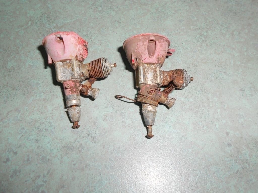

Hello friend Bob, I'm glad you got those pieces, they really deserve to come back to life ...
I saw them published, just keep the photographs, since from here it is very expensive to obtain the spare parts.
Keep these photos waiting for someone with a lot of love and passion to get them and put good rebuilding hands on them.. drunken

Go down to the auto parts store and grab a small container of Evapo-Rust. It is a non-caustic solution that removes the rust leaving the parts looking new and will not harm the plastic. It really does work, I use it for rusty auto parts.

BTW, I mentioned it elsewhere, but the listed .010 engines are actually TD .020’s. The center post on the heads are dead giveaway.

At some point you may want to try a 50-50 mixture of acetone-automatic transmission fluid for penetration. Be advised, however, that you will need to shake the solution up at least once daily as the two components do separate. Suerte Che.

Thanks all, I'm hoping that perhaps enough castor remained to protect the interiors, but it's doubtful. A lot depends whether these were burned years ago or last month. Rust never sleeps. I'm eager to find out.
Yes, that diesel head was what convinced me to bid.
Looking for Evapo-rust. Good stuff about it on google. I have a product called Rust-Mort -death to rust, but it wouldn't work in this case.

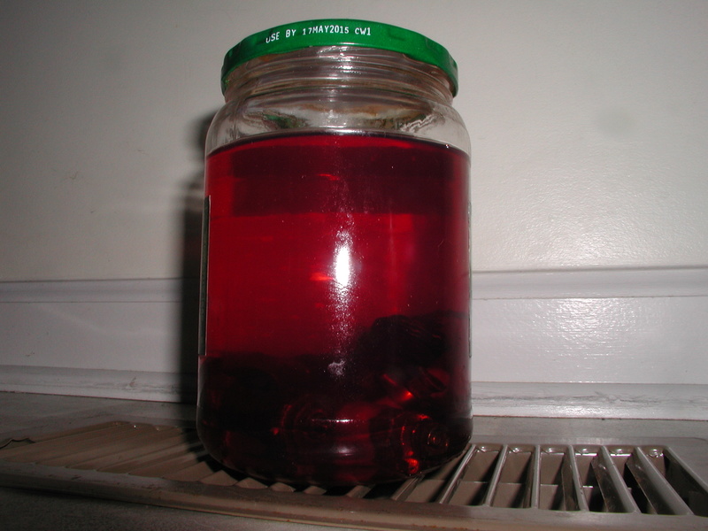

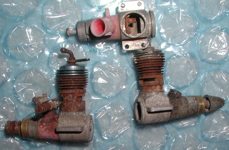

Well, after an eleven day stint in the USPS system being tossed around from small town to small town they finally arrived.
As expected they are toast literately, but hope springs eternal. On short notice a 50/50 mix of kerosene and Marvel Mystery oil in a pickle jar may loosen them up. I couldn't find Evapro-Rust in the local Walmart, but will get some eventually.

I think that will work just fine

Hang in there Bob. It was a real gamble on the .010. Soaked what was left in a solution of ATF and Acetone for a few days. Applied heat...gently... and was able to loosen the glow head from the cylinder. The .010 venturi along with the needle valve body and needle was missing. The carb body was toast. The attached tank was punctured. It came with a toast .020 needle valve body and venturi sans needle valve. I located a .010 needle valve body and needle/spring. (Those are fun to find.)  Had a spare .010 carb body.
Why all this time and effort? The .010 piston/cylinders are unobtainum. Got lucky on the project...Very Lucky!

If you do get them free and apart spinning the cylinders in a lathe using 400 grit sandpaper between the fins to clean the rust out and re-blueing the cylinder will look like new. As long as there isn’t any pitting in the cylinder it should run.
