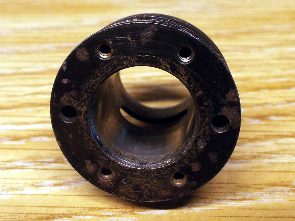

Jason_WI wrote:As long as there isn’t any pitting in the cylinder it should run.
Depends where pitting is and the extent of pitting. My K&B .35 Stallion's pitting was in the upper cylinder area of the compression chamber for combustion.
Just curious..Cox burned engines - Page 2 2018-031
Just curious..Cox burned engines - Page 2 2018-042
As a result, there was no blow by to the exhaust and intake ports and compression was excellent. I like Ron's idea of using Evapo-Rust, which will remove the crusty stuff back to bare metal. Then what is left can be dealt with. May not even need a lathe, fine steel wool might suffice.
It is on an as case base situation, so it will be interesting after rust removal to see whether the situation is salvageable or not.
