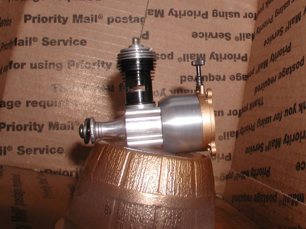

Same procedure as my other Silver Bee only this time I elected not to remove the cylinder. Down side, I won't be able to reset the connecting rod, if it was needed, and I can't replace the tool marked prop drive washer. I'll live with it.
Krylon gold paint photographs darker than it really is.

I wonder how the back plate paint will hold up to fuel. (especially the gray on the inside)

Post  rsv1cox Sun Nov 25, 2018 2:23 pm
ticomareado wrote:I wonder how the back plate paint will hold up to fuel. (especially the gray on the inside)
The gray is sandblasted metal.
The gold paint is for show and tell, but I haven't subjected the others I have done to fuel. That is something I must do to answer my own question about it. I could spray it with Top Flights clear. Best approach if it ever becomes a runner is to just sandblast it again.
Yup, I have the tool to do just that regards the drive washer. Thanks for reminding me.

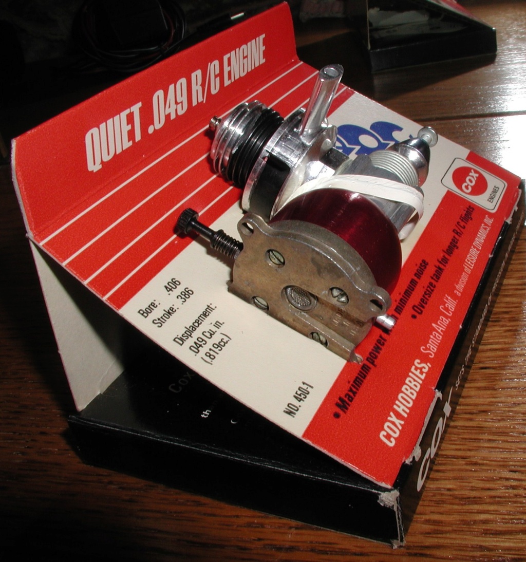

Silver Bee cleanup Cox_en13
A couple of my NIB engines, maybe not a true representation of how they came out of the factory 36 years ago due to fading.
Silver Bee cleanup Cox_en14
Silver Bee cleanup Cox_en15
I was hoping that Dannels/Sitter (Cox Model Engine Handbook) would provide information regarding the finish on the back plates, but while they picture the metal back plates virtually nothing about them is there, spending time on the "plastic" horseshoes and postage stamps instead. They do say that Cox used various types of plastic though and the he uses "Delrin" loosely as a descriptor.

The paint does look good, definitely better than chipped/corroded original. The only minus is that it probably won't tolerate nitro, but for a display piece that is not critical. I like the way your Silver Bee turned out, very original look. I tend to "over-polish" mine, I guess it is the magpie within...
I am pretty sure that the backplates on those NIB engines would polish easily to the bright factory finish. The plating is very thin, so hand polish only with some very fine compound.
I was just thinking out loud about the plating, it would be a neat touch to a custom engine. Someone here polished a corroded backplate to bare zamak, it was like bright aluminum. That would be an ideal base for copper plating I think. Maybe even gold Money Toss Definitely not original look but very "bling".
I have also noticed that pretty much all the plastic backplates are referred to as "delrin". I think only the red postage stamp backplates are delrin (possibly white ones too) and the horseshoes are of some other plastic. Even the red horseshoe backplates "feel" like they are made of harder and more brittle material, similar to the plastic used for the Cox airplanes. Not sure, but having "modified" both types of backplates, I felt a difference. Postage stamp material is easier to cut, file, sand and polish compared to red horseshoe material.
